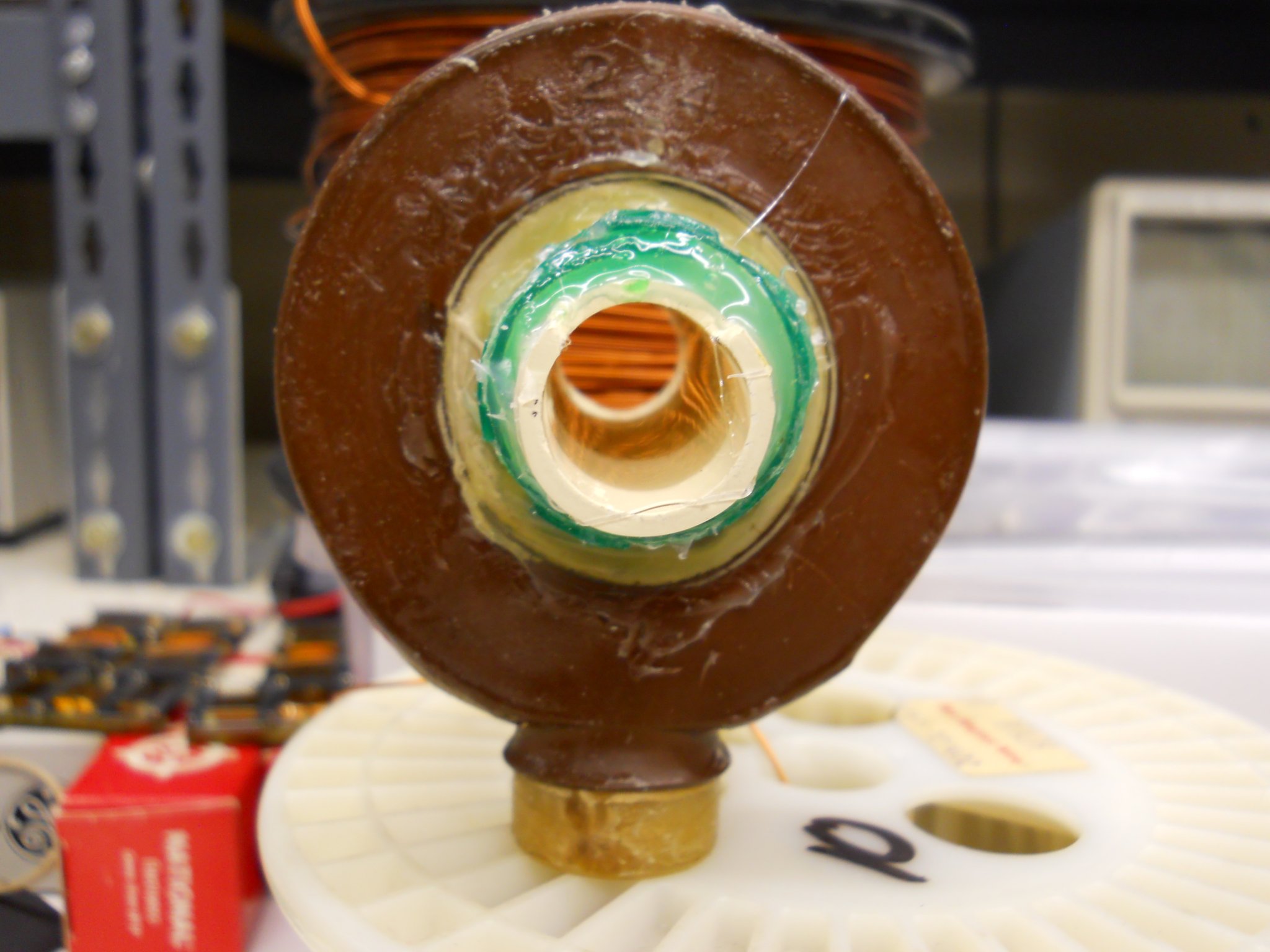

The most desirable transformers are those intended for direct production of full (AC) EHT potential for application to external 'non-multiplicative' rectification pursuant to development of accelerating potentials for large CRTs -- Contrary to 'conventional wisdom' such units are yet readily available from long-established electronics supply houses (whom, in my experience, are only too happy to wave 'minimum purchase' and 'wholesale only' policies at the prospect of disposal of what they regard as 'dead stock') --- That said, one should expect to size their purchase so as to offset the supplier's 'invoicing costs'... Prices ranging from $20 (USD) per transformer (in reasonable quantities) are not uncommon...
The following images are offered as an aid to recognition of the desired form factor:
Assorted LOPTs typical of the desired geometry:
vvvvvvvvvvvvvvvvvvvvvvvvvvvvvvvvvvvvvvvvvvvvvvvvvvvv
Detail - Axial view:
vvvvvvvvvvvvvvvvvvvvvvvvvvvvvvvvvvvvvvvvvvvvvvvvvvvvv
Detail - Transverse view:
vvvvvvvvvvvvvvvvvvvvvvvvvvvvvvvvvvvvvvvvvvvvvvvvvvvvvvvvvvvvv

Step 2-11)
Permanently install CPVC form sleeve in EHT winding assembly:
Image of components referenced in this step:
(L to R) CPVC sleeve, EHT winding assembly, Form [core] pieces
Tasks:
1)
Assemble EHT winding, CPVC sleeve and form as shown (below).
2) Using PTFE shims, center EHT winding assembly about CPVC sleeve (both sides).
Note: While the adhesive does not bond PTFE it is, nonetheless, essential that the shims be so formed as to preclude (interlocked) captivity in the former!
Images of mounted and centered EHT winding as seen from 'EHT return side':
4)
Using acrylic-based 'hot-melt' adhesive, tack the CPVC sleeve to the polypropylene shell at several points each side.
5) Remove form pieces.
6) Fill the space intervening the CPVC sleeve and the PP shell with acrylic-based 'hot-melt' adhesive taking care not to disturb the relative positions of said structures!
7) Allow the adhesive at least 60 Minutes to cool/cure.
8) Withdraw the shims.
Image of assembly immediately following withdrawal of shims as seen from EHT return side.
9)
Fill the 'shim gaps' with acrylic-based 'hot-melt' adhesive.
Image of EHT winding assembly following completed installation of CPVC sleeve.
