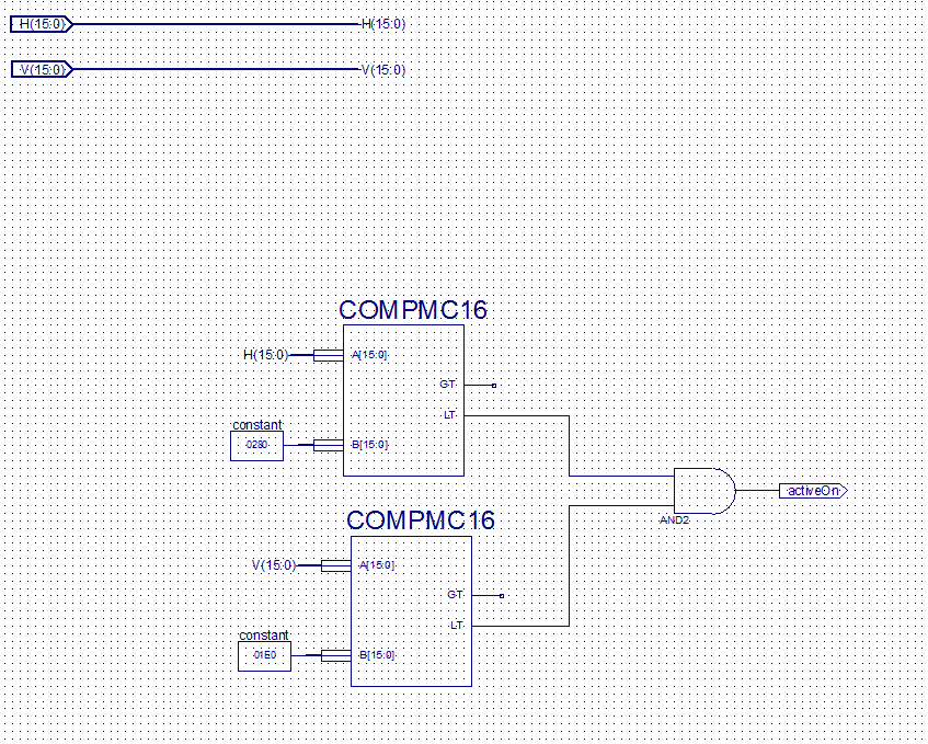

I was successful in implementing my methodology of using comparators to paint specific pixels different colors on the screen. Turns out I had a few wires crossed that was causing my output to be skewed.
Here is what I have done.
Two 16-bit counters that are continually counting. First counter is for hSync that will count until it reaches 799 - upon reaching that value it asserts the reset switch as well as asserting the CE on my secondary counter which counts all the way to 524 and will then reset. I have sets of comparators that will look at my counters and will tell both hSync and vSync when to be on or off depending on what the value is in the counters. I have also done this for my active region. I am looking at my screen as an x and y coordinate system:
active region is high while: 0 < x < 639 AND 0 < y < 479.
I ANDed this together with my hSync and vSync signals and am sending the signals to my rgbColor decoder and I am able to successfully paint the screen.

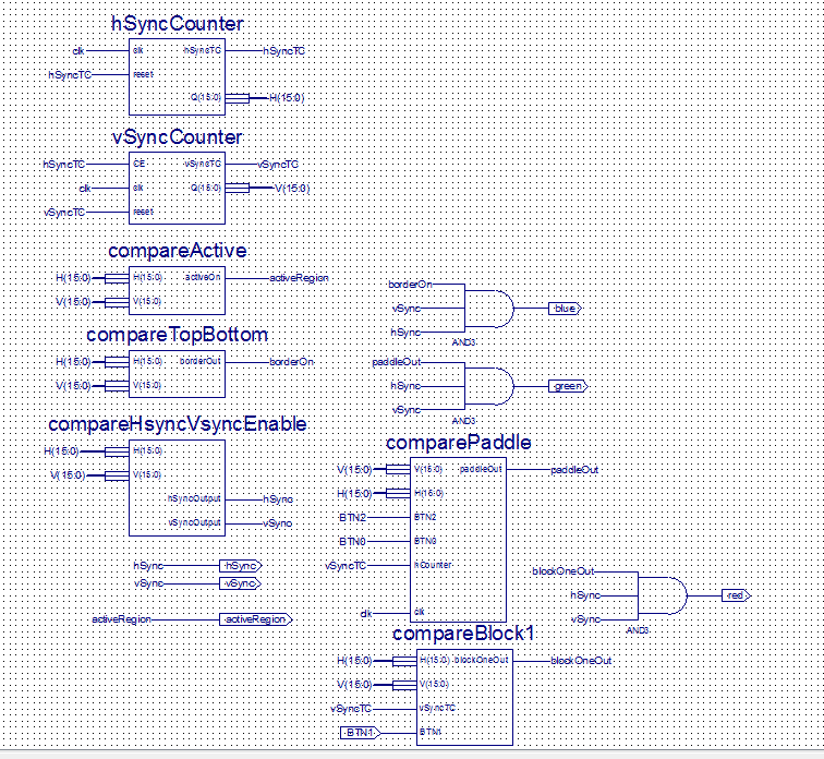

Can you post an image of your current schematic to perform this action?
You should have a way to clock the colors out from a linear block of memory. That way, the random blocks can be written to memory in a parallel process to the screen being drawn. Attempting to do both at the same time with the same logic can cause "tearing" or display jitter do to very small timing changes.
If you set up your clock for pixel rate, Hsync, and Vsync rate, then adding the link to pull the pixel color area from memory should be a simple change of the source of pixel data.
Your method may work, but what happens when the next assignment is to draw a Mandelbrot set on the display? Without a framebuffer, you'd need a calculation unit for each cell built into the display hardware, and you would run out of Logic rather quickly.
Another downfall of your current method is upgrading to 4 bits of color per pixel requires a top-down re-design.

I will post the schematic (well what I have working so far) of my vga controller and the inside look of one of my symbols.
Here is my schematic with my other symbols. As you can tell by the names they are pretty straight forward: hSyncCounter contains a 16-bit counter that has an AND gate that will assert a signal when it hits 799 to reset the counter.
This is one of my comparators that I use to check and see where the counter is. While these arguments are satisfied H(15:0) < 16'h0280 and V(15:0) < 16'h01E0 (H(15:0) is the count coming from the horizontal counter and V(15:0) is the count coming from the vertical counter) it will send a high signal that the count is in the "active region".

And a response to WBahn that was only but a small portion of my assignment. Instead of making a new topic I continued to post in the thread - thought it would be better to do that rather than spam the forums.

Do you see a way you could use clk*Hsync to "count" through a separate memory bitmap of colors for the pixel out? Think just blue/black for now.
Then decide what needs to be changed to read 3 bits for each color from memory for the outputs (active region AND memaddr for color).
Once that is done, any future changes, such as a triple border, drawing text, etc. can be done by modifying the memory the output reads for outputting the pixels.
