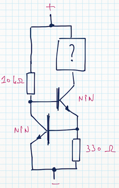

I'm not a fan of the one resistor approach as the voltage is unknown. I've also seen wild fluctuations due to the chronic electrical problems this car is known for, dipping down to 10 volts at times (it's a common problem with this car), so I'm sticking to strings of two unless I have a way to bump up the voltage first, which itself seems excessive.
Two transistor approach sounds fairly simple. Is this the one you meant?
That question mark is where the LED string goes. If it is, how do I hook up multiple strings? Is there a way to share components, or slim down the overall count with a transistor array?
Yes, but my suggestion is to drive the upper transistor off a logic-level input, not off the + supply. It would be able to control the LED current and also to function as a switch to let your PWM input (from LM555 oscillator? from processor?) control the brightness.
I think 330 ohms as the sensing resistor is wrong; to get something close to 50mA you'd want 12 ohms. (V/I = R, so .6/.05 = 12)

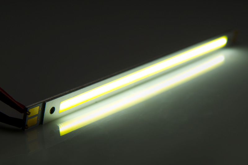

Ok.. I wasn't thinking you were talking about the cosmetic look of the light itself.. Thats mostly how LEDs are now besides the "optics" manufacturers mold into the lens to spread it.. Its a point light source..
Then COB LEDS might be your best bet.. Its tons of LEDS tightly packed covered to blend the output into a virtual bar of light like this..

I like that. Only question is if they make them bright enough and properly sized for my application. I don't suppose you know of one that's 14 mm to 16 mm long?
