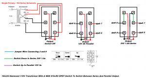

Edit: It was pointed out to me I could better state my question.
My project requires the use of 24V and 12V (one at a time) from the same pcb mounted power transformer
My transformer outputs 24V @ 1.5A in Series and 12V @ 3A in Parallel.
Which of the following wiring diagrams are correct for using a DPDT toggle switch to flip back and forth between series and parallel?

My first attempt
Here is how one of the guys on Instructables recommended I wire it.
Here is another option I came up with, To me this seems to make the most sense, Clean and simple. However I could be way off.
I thank you for your help and advice in advance. I welcome any and all input.
