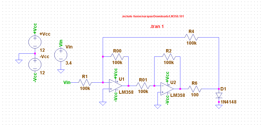

Ok, I think this might be what I need.
But I want to know how this circuit works, therefore I want to evaluate the currents and voltages on all nodes of the circuit.
I started by assuming the 2 OpAmp inputs are at the same potential, therefore I assumed 0V. this way I can evaluate the current flowing across R1 which is:
I_R1 = Vin / R1 = 3.40V / 100kΩ = 34μA.
But now how can I evaluate the current across R4, C and the first R0 which I called R00??? I know the C data, which is 1μF. Hoe can I do this?

Attached is the schematic diagram of the linear current source of post #25 of this thread including power supply, omitting the capacitor, and shown built with a particular op amp, the RC4558 (dual general purpose from TI). I've also added a voltage divider at input to the circuit to provide a constant input voltage, just for testing.
In order to clearly show the correct connections from the power supply to the circuit, I show the power supply as two 12V batteries connected in series. But of course a battery power supply is not required, it will also work with a bench power supply.
The voltage divider causes Ei = 1.1V. Given that R3 = 100 Ohm, then
IL = 1.1V* 10 mA/ 1volt
IL = 11 mA
You can confirm this by measuring the voltage drop across RL, or reading current directly through RL with the ammeter function of a DMM.
Replace RL with a low current-type LED, and IL remains equal to 11 mA (about). A current limiting resistor in series with the LED is not needed, as this is a current source.
If 680 Ohm > RL > 100 Ohm, then IL = 11 mA with some small variation, possibly due to the resistors being 5% tolerance. If RL > 680 Ohm, then IL starts to droop (decrease to < 11 mA), presumably because of max output voltage swing that is less than the supply voltage.
The pin- outs of RC4558 and LM 358 are exactly the same. Although pin 4 of LM 358 is labeled ground, it is correctly connected to -12V of the power supply, not to circuit ground which is the common connection of the two 12V batteries.

Anyway my circuit doesn't have a voltage divider at the input. I have there a 3.40V directly across R1.
I would like to stick with my components as I can't use the ones you used to check my calcs.
Even without the cap, the current flowing through R1 would be the one I found in my previous post! I_R1 = 3.40V / 100kΩ = 34μA, correct?
Then, I think, as we have a node that "splits" into 2 branches with the same impedance, 100kΩ, the previous current would also "split" evenly into those 2 branches, resulting in a current of half of the current that "enters" in the node, therefore, 17μA! But I can't confirm this last current value!

This is the circuit I'm testing, but also LTSpice turns all currents "backwords", don't know why. Also current values ar not even close to what LTSpice shows.

Is the load in the circuit that you are testing 1N4148 (a signal diode) or a LED?
Yes, your math is correct. Analyzing how this circuit works I think is not too easy. Offhand, I can't explain, but with some effort might be able to. There are (engineers) at AAC that understand how it operates. Nevertheless, this is a fairly ingenious and unique type of current source.

In the LTSpice circuit I used the 1N4148 just because there was no green Led in the database (i guess). But in the real circuit, I'm using a green Led.
Anyway, I can't measure the correct values that LTSpice is measuring. Don't know why! I know that if I rotate the resistors by 180º, the currents also changes, if I'm not mistaken. Anyway, the absolute values should be close to my calcs.
