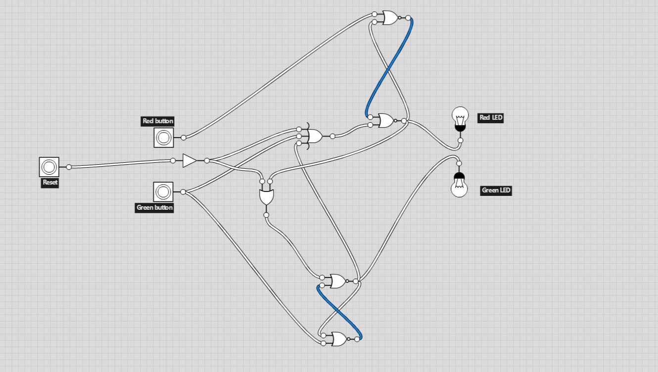

I have started designing a basic cue light system for theater or TV use.
Basically what I want it to do is have 1 master station and 4 outstations. When a red button is pressed on the master station, the outstation lights up with the same colour. Then when I press the green button, the red light turns off, and a green one turns on. So far I have a working prototype with 2 buttons and 2 LED's, but when the green button is pressed I have no way of turning off the red LED.
The main issue is finding a way to stop the red LED from receiving power when the green button is pressed.
Both buttons are latching, and have their own 12v LED that is switched with them, both LED's are 12v also and connected in series via an audio/DMX cable(3pin) with pin 1 as green+, 2 as red+ and 3 as neutral.
Any help would be greatly appreciated!
Thank you

Looks good, but a little bit complicated as I'm not familiar with relay circuits! I've come up with a design that uses NOR gates to latch everything, and have added a reset switch for the latches.
When red is pressed, red lights up. When green is pressed, green lights up and red goes off. From there, red can't be pressed again until the system is reset, which turns either light off. I will try to send a picture of it in a bit!

Yet more late information. Maybe a wiring diagram is in order.
ak
Here is my first attempt at a circuit. I realise it's all digital on here, but don't know enough to turn it into a real design (with 12v power etc) so for now this is just a proof of concept. Any improvements to the design would be greatly appreciated!

Use AK's circuit in post #16.
It only uses one IC chip, while your circuit requires at least two.
That chip can be powered directly by the +12V.
