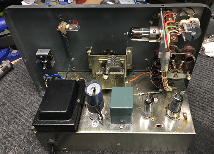

If you look at the Band switch, it has 2 screws. This does not seem consistent with the rest of the generator. Looks like someone replaced that switch. Something may have been wired up wrong or maybe it isn't even connected. You might want to pop the cover and take a look.
And I will bet that frequency control in the center is broken. It might be connected direct to a pot or variable cap. Or it could be connected via a string like the older radios. They would break a lot. And a pain to restring. ;)

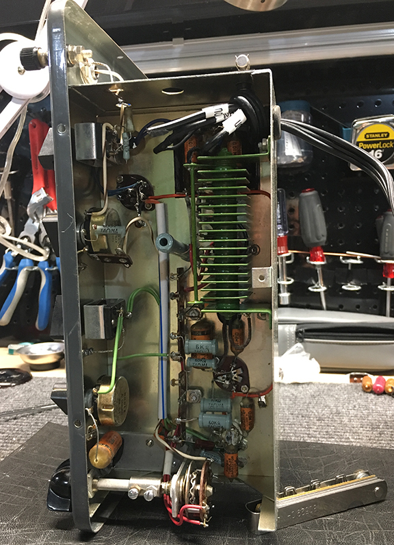

Tested tubes, all good. Looks like I have some parts replacing ahead of me! Selenium rectifier, wax caps, electrolytic, testing of switches...........

I would start with the switches. Of course if they have been replaced before, there is no telling if it was correct. I would look at that Band switch. See if you can trace it out and figure where is is going.
I would also be interested in the function of the switch in the lower left (as looking from the front). Did you turn it to see if it has any affect? How many positions does it have?

While I am thinking about it there is something you may wish to consider. That large green selenium rectifier has a few schools of thought behind it. I am not going to jump up and down screaming replace it but also won't say don't replace it. Literally a few dollars will buy you a handful of 1N400X diodes rated for 1 Amp and up to 1,000 volts (1N4007). I doubt the existing selenium rectifier even comes close to a PIV of 1.0 KV or 1.0 Amp forward current but take a look at the 1N4000 series data sheet. Page 3 of the linked data sheet shows the curve for forward voltage drop verse forward current. At 200 mA which is likely close to your existing selenium rectifier the silicon diode has a forward voltage drop of about 0.8 Volts. Therefore in for example a full wave bridge configuration you will have a forward voltage drop of 1.6 volts on alternate half cycles of the AC voltage in. The old school thinking on a selenium rectifier was about 1 volt per plate per rectifier and since the plates were stacked you could have several rectifiers in a single stack. The end result of all this would be the DC voltage going to the filter caps will be higher with the new diodes. How much higher I really don't know and I really don't know what effect the increased B+ voltage will have on overall circuit performance. Just something to consider.
You didn't mention the tube types but at that point in time tubes like the 12AU7 were popular as the heart of the oscillator. The power transformer generally had two black leads for the primary, two yellow leads which were about 6.3 VAC secondary for tube heaters and two red leads which was the high voltage AC to the rectifier followed by a Pi configured filter of a few capacitors (or a single dual capacitor) of 20 to 30 uF rated at 250 to 350 VDC depending on the B+ voltage used. If yours used a 12AU7 The tube has a dual filament which can be configured in series for 12.6 volts or parallel for 6.3 volts operation. The 12AX7 and 12AT7 were also popular for the era.
The guts look super clean which is really nice to see and in your first image I see the small trimmer cap on the top right which might be the internal modulation oscillator but I really don't know but it is where the front panel tweaks are.
