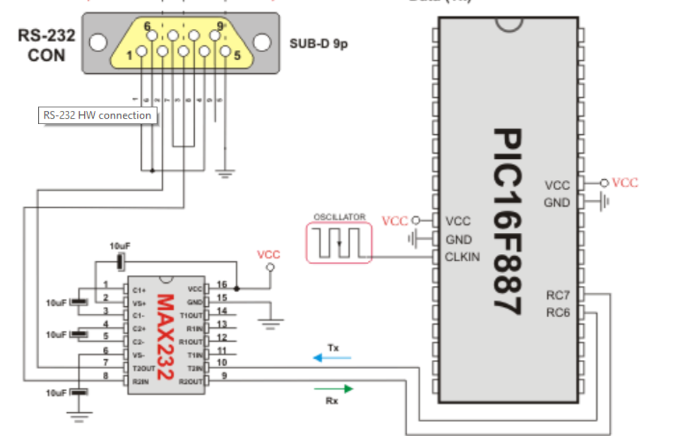

Below is the picture of the modem
In the Picture it is connected to PC's RS232 Port directly.
I can communicate to it using MikroC Pro's USART Terminal.
So far I can call and send sms.
I am gonna connect this modem to a PIC's USART.
Question is to Send Data and to check the modems respond what terminal (like CTS) needs to be connected to PIC besides TX and RX ?
And Do I need a RS232 level converter (such as MAX232) between PIC and Modem ?
If yes (MAX232) Do I need to converter all the levels besides TX and RX ?

Most RS232 communication now does not use a populated Null Modem cable, just the three lines RX/TX/ and GND.
If necessary the handshake can be jumpered 1-4-6 & 7-8
The MAX232 and equivalents will interface the Pic.
Usually the pic will monitor the interrupt for receiving the speed of which does not require hardware handshake.
With full populated Null Modem all have to be level converted.
If H.S. is required, it is usually done with a S/W H.S. such as XON/XOFF code.
Max.

Since you do direct connection to pc, this tells me that you have +/- 15 volts signals. Which in turn tells me that you need MAX232 to convert those 15 volt signals into 5 volt signals that PIC uses.

Modem is compatible with 9600 and 115200 baud. No problem.
Modem manual says.
115200 Baud, 8 data 1 stop, no parity. no flow control

I checked the Maestro with just TX and RX connected to com port and it still works.
I can see signal strength and SIM status plus network plus send SMS :D
So, is it safe to assume that I do not need any other connections to PIC to check and do the above ?;)

I was referring to the Sub-D socket as in the picture (should show a 9s not 9p) , usually used to accommodate a pre-wired RS232 cable.
It shows pins jumpered.
