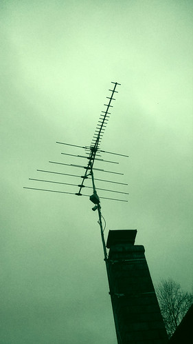

I had a decent distribution for 8-12 locations and then something happened. It wasn't characterized until recently, so I don't know what exactly I had.
Before a frequency re-assignment, I was able to measure ATSC gain (dbmV) at various frequences at 3 points in my system. A lot of channels moved to VHF.
1. Antenna = Winegard HD 8200U
2. About 30' from antenna in attic after before power injection to a mast mounted Channel Master CM-7777
3. Then probably 40' to distribution. I have a TV tat's easy to connect at this point.
1 & 2 were not done at the same time, but were done the same day. 3 was done on a different day.
Not sure if I had an amp at point (2).
Gain from 1 to 2 done by subtraction. They were not consistant, so I want to replace that amp. I bought one with a very low noise figure, but it is not installed. It has a little lower gain.
A tV at point (3) performed fairly well, but when about 30-40' of lead was added to the most used TV, it's not enough gain. Need about 5db.
