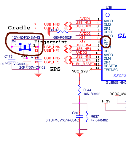

Hi everyone,
I have two USB hubs on a board which work just fine, but it's only when I plug a USB device in that I can see a sinusoidal crystal signal. And furthermore, it's only on "X2", the "Xtal Out", not on the X1 (in) pin.
a) How can there be an output when there's no input?
b) I thought crystals were totally passive devices which produced sinusoidal signals always. Why is the sinusoidal signal appearing and disappearing?
Thanks!

Probe capacitance is affecting the oscillator circuit when you probe it. One side of the xtal is connectoed.to the oscillator bufferoutput and might be able to tolerate more load capacitance... thus the asymmetry.

I'm a little confused still.
So pin "1" of the crystal producing a signal, and pin "3" is just simply accepting a signal from the usbhub IC?
Why does the IC output a crystal signal?
Also, Pin 1 is producing a signal that I can't see because my oscilloscope interferes with it?

To make an oscillator with a crystal, an active element providing gain >1 and positive feedback is required. The IC has something like a CMOS inverter that drives the crystal and produces a stable is oscillation at the crystal's resonant frequency. The crystal just responds to the drive signal, it doesn't create a signal alone.
You can buy self-contained oscillators that have 3 or 4 pins, and then you just apply power and ground and get a clock out.
