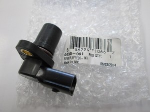

Which Hall sensor are you connecting to and what outcome are you looking for? You have my curiosity.
I don't know what type of hall sensor this is. It has no labels on it, its for an ATV. As mentioned earlier, this is a 3-pin hall sensor, where the supply voltage for the sensor is 12V. I've measured that!
Here's how it looks : https://i.ebayimg.com/images/g/JgMAAOSwFAZTtZce/s-l300.jpg
I'm aware of the vehicle insurance issues and all that, but thats not an problem I have to deal with.
How can I create a 12V square signal from a 12V supply (vehicle battery for instance) and send this to the ECU? I use an Arduino UNO and control a BC547A NPN transistor from it. What kind of circuit must I have, in order to "limit" the current (10mA maybe), but at the same time maintain 12V signal for the ECU?
