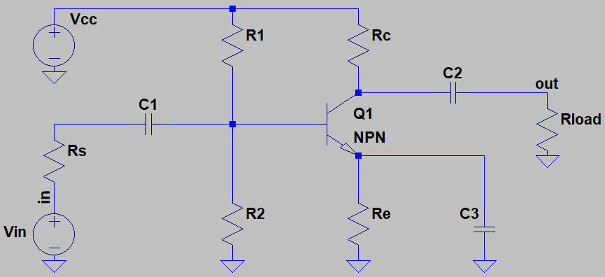

Hi folks,
I am trying to make an amplifier to amplify a sine wave from the waveform generator chip AD9837.
I am looking to generate a +-5V sine wave (AC coupled, 10Vpp) that will go through an inductor coil (1.5 ohms) with 500mA of current. If needed for circuit design purposes, I can add a resistor to the inductor coil. BTW the inductor coil is represented by the resistor Rload in the diagram below.
I have npn transistors, MOSFETs, and op-amps in my toolbox so I thought it should be fairly easy to make this amplifier with what I have. I am not sure any of my op-amps can output 500mA so I decided on using the npn transistor. I found a great tutorial using an npn transistor here:
http://www.atakansarioglu.com/transistor-practical-common-emitter-ac-amplifier-design-npn-simple/
I am using the exact circuit in the tutorial, except that I went through and did the math to design this circuit for my purposes. I got through parts of the math but certainly not all of it and came up with the attached circuit called "my common emitter". The double ?? means that I did not solve for that component and it is a random value. Even the components I did solve for there could be mistakes. If anyone uses LTSpice I attached my partially solved circuit.
I am having a HELL of a time figuring this out. I have probably 10+ specific questions but I guess my first question is, is this the easiest way to amplify my sine wave?
I wanted to try a common source MOSFET amplifier but I want to simulate it in LTSpice before assembling the circuit and none of the MOSFETs in my collection have models in LTSpice. The reason I picked the common emitter circuit is because I have a BC337-40 Transistor and I was able to find the LTSpice model for it. If y'all think that this common emitter IS a decent way to accomplish what I am going for then I will continue with the specific questions, but I thought it would be smart to broadly ask if this is a good method first. Thank you.

Also, just in case anyone is a circuit magician and feels like solving this common emitter in LTSpice, here are some important input values.
1kHz sine wave
Vpp input could range from 1Vpp to 5Vpp (would be DC coupled coming from the AD9837)
No idea what the source resistance from the AD9837 is.
Hope that helps.

Audioguru
Joined Dec 20, 2007
11,248
1) Your little BC337 transistor is biased with the value of R2 so low that the input signal is shorted to ground and the transistor barely conducts any current so it does not work. If the value of R2 is increased so that the transistor is biased correctly then the transistor will smoke and burn because it is too small for this job.
2) The Source Resistance of your signal is way too high plus the additional extremely high value for Rs makes it worse.
3) The values for the coupling capacitors are much too low.
I agree that you need a class-AB amplifier module instead.
BobTPH
Joined Jun 5, 2013
11,659
Your numbers don’t add up. If the load is 1.5 Ohms, and you put 5 Volts on it, the peak current is 3.33 A. That is 2.35 A RMS. So which is it, 5V or 500ma? Sorry, you can’t have both.
Bob
