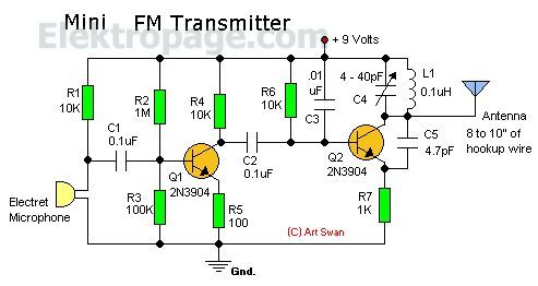

That's too little for the calculation of an oscillator.
I am familiar with colpitts common base:
http://www.elektropage.com/images/circuits/mini_FM_transmitter1.gif
There appear into account the parasitic capacitances of transistors and hybrid Parameters.
Phase shift at feedback A first it is given by capacitor C5 and that seems to be only 90 degrees.
C5 provide a part of collector signal with phase shift in emitter.
Motanache
Joined Mar 2, 2015
652
The two conditions (the phase and gain) are for self-sustained oscillation.
But there must be met and necessary conditions to start oscillation.
Even more strange mathematical is that I do scheme without R3 and works.
