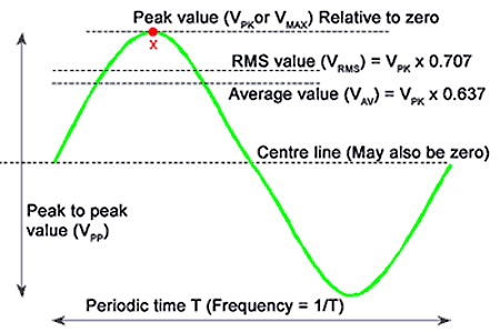

Your drawing is incorrect. Review your question and correct the drawing.
Review the terms RMS, peak, average, and peak to peak with respect to a sine wave signal.

@JoeJester Note that the Average Value for the green waveform shown is 0V. I think it is trying to get at the average value of the full-wave rectified version of the green waveform.

The mathematical average of a sine wave is zero, but the average voltage of a sine wave voltage source is taken to be 2/pi times the peak, which is about 0.637 times the peak, and this is correct even though it goes plus and minus and would normally average out to zero over any integer number of full cycles. Mathematically that is the average of abs(sin(wt)) which is the average of the absolute value of the sine wave which of course is the average of the ideal full wave rectified sine voltage.

Taken to be that by who (whom?)? I'm not being snide, I've just never seen (that I recall) the claim that the average voltage of a pure sine wave is anything other than zero (before the graphic that JoeJester posted, anyway). If I pass a signal through a low pass filter (of appropriately low cutoff frequency) I will see the average value of the waveform. If I pass a pure sine wave through such a filter I will see zero (or very nearly zero) at the output. I will NOT see 2/pi times the peak. A sine wave and a full-wave rectified sine wave are two fundamentally different waveforms.

That graph illustrates the average position on that half cycle, not the whole wave. If we did the same for the negative half, it would end with a zero net sum.
I don't recall if my instructor from 1973 specified it was for just that half cycle. It was my mistake for not specifying the values were only for the half cycle specified on the graph.
Of course, if we connected an analog multi-meter to that signal, the signal is full wave rectified prior to the input of the meter circuit.
WBahn is correct because I failed to clarify that graph with text.
