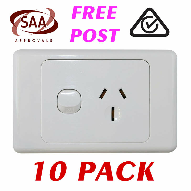

In Australia the sparky term is "gpo" General power outlet.The most common term here is power point,basically 2.5mm2 wire coming from the meter leading to a 10amp gpo Edit I am still building the shed 5m x 3.5m pretty small but the biggest allowed by council.I have run a 6mm2 twin and earth from the meter box to a sub panel,most of the power points will be on 2.5mm2 wire but some for the heavier drawing equipment will be on 4mm2. An electrician friend will come and check my work and do the main connection
