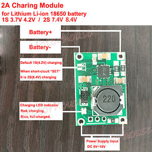

I apologize for my stubborness, I just wanted to create something on my own.
I'll take the advice and I've been looking for a charging protection module.
The one i've found is: https://www.amazon.com/SMAKN®-TP5100-Synchronous-anti-reflux-charging/dp/B015DX0422
Does this one seem alright?
Adapter voltage = 12V
TP5100 Vin = 8.8V~17V (2 cell in series)
TP5100 Vout (max charge) = 8.4V (2 cell in series)
TP5100 Iout (max) = 1A-2A (variable by replacing a resistor)
Is this good enough?
