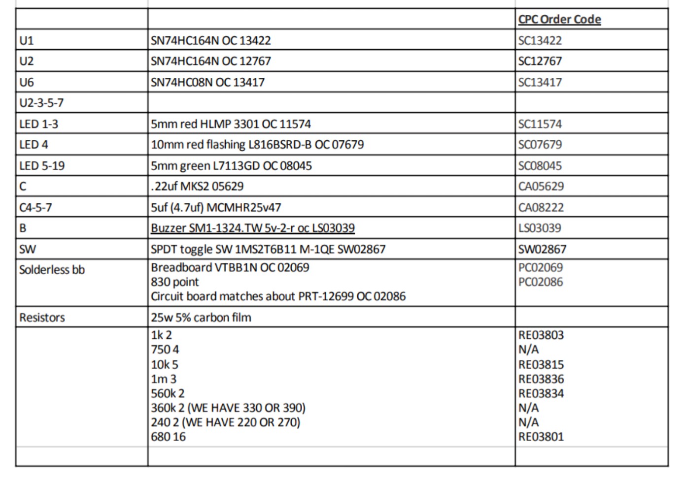

OK so have now had an answer from CPC... This is the parts list that they think is needed from the information I gave them .. Have I missed anything?
Bernard
Joined Aug 7, 2008
5,784
Missing from list is: D22, D24, 1N4148; U 2,5,7, NE555P, order code SC08618, & 5 each 0.1 caps.
To limit the number of different R values, 240, 680, 750, & 1k, all have been replaced with 390.
Has the minimum order number of 50 or 100 resistors been resolved?

Sorry Bernard, I don't understand the parts you are asking me to order.. I asked CPC and they just said...
Hello Ross,
If you could provide a list of components and specifications that you require, we could source the correct items from our stock to meet your specifications as we have attempted to do previously.
I can confirm that some of our resistors do some in packs of 50 or 100 but this is stated on our website.
If you could comprise a list of the components that you require, we can provide our Order Code Numbers for suitable items.
Regards
CPC Technical"
I have already explained to them that I'm a complete novice... Their first email was great but this second is like being properly winded... Completely unexpected :(

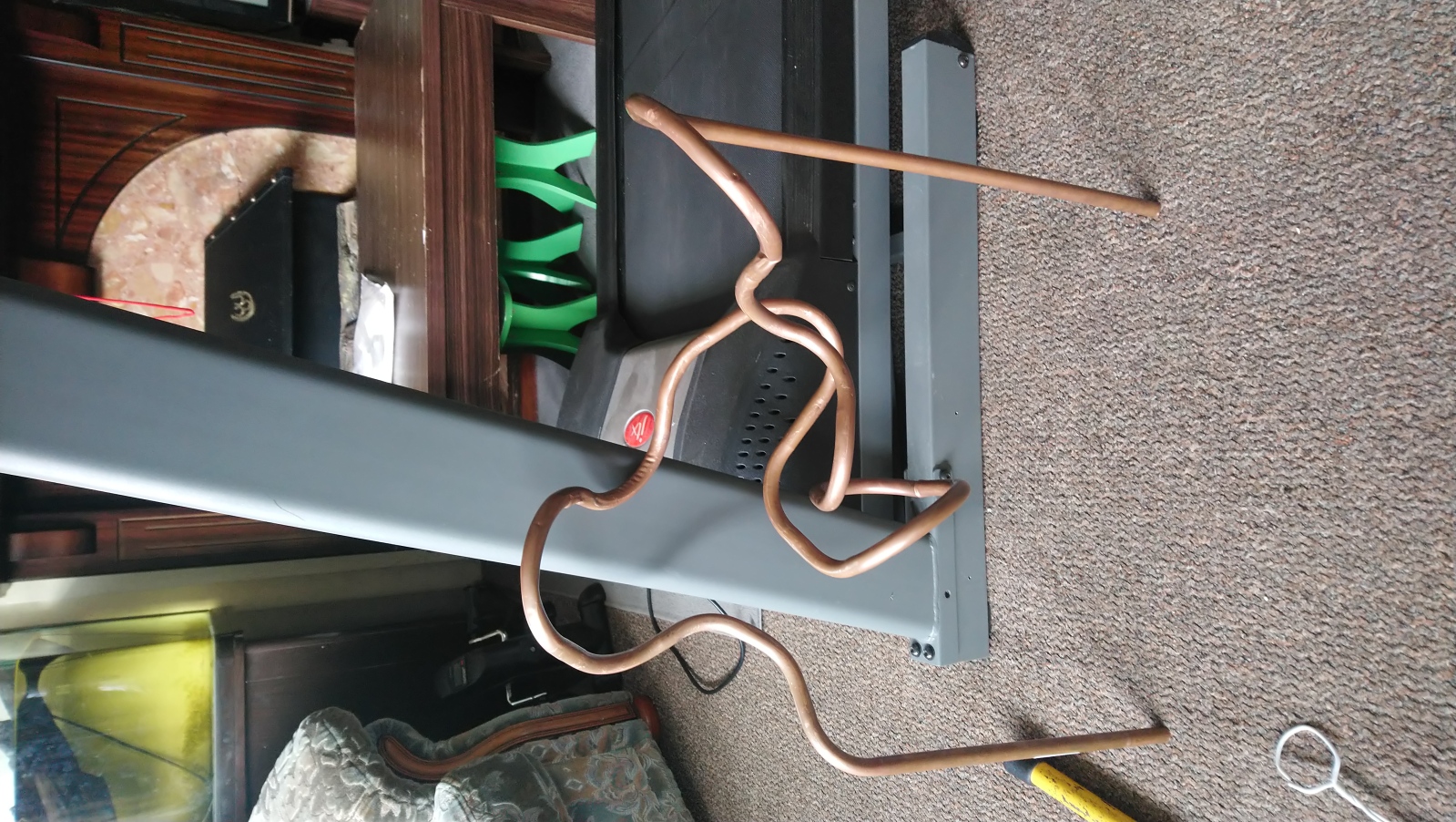

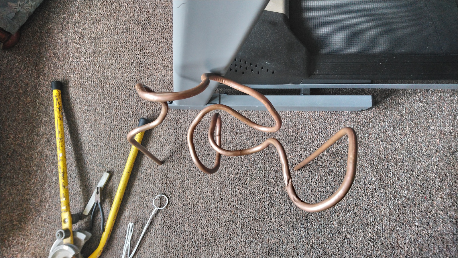

On a brighter note I've managed to bend my copper pipe into something I'm happy with... Its not brilliant but it will do.. Wanted it in one line but getting it to do that was hard and now I have areas where it I try and bend it again the pipe is going to snap... Let me know what you think :)

Post # 46, part list: U2- is a 555, order code SC12767 is for SN74HC14N, U3 on schematic.
U 2-5-7, NE555P, SC08618.
You could start ordering process by making a list of all parts, ICs. Rs, Cs,Ds, & miscellaneous. Rs go from 1 to 42?
note- there is no U4, D24 is no longer needed, & there are some parts added by @eetech00 as " good practice" but some I would skip, your choice. R 40- 34-, C 14-15-21.
Add up common values in each list & maybe add a spare on two for order quantity.
As I said before, Mouser will sell Rs with minimum of 1, CPC will not.
I breadboarded U1 to U2 successfully but had to use the spare U3's to condition the input to my 74LS 164's.

Hello,
When you fix the curly pipe at one side (that is connected to the electronics) and a liftable end at the other side, you can make different difficulty levels by using differend size slide rings.
A large ring will be much easier than a small one.
You can slide the ring on the game using the loose end.
The rings can be connected using a bus and plug system.
The bus can be hidden in the handle and the plug mounted on the ring.

OK so have gone on the CPC site and placed the items I can figure out into the basket.
From looking at the drawings I can see lots of D parts not just D22 and D24... Do I need to order more of 1N4148
Not sure what you mean regards "5each 0.1 caps." and when I've looked at the resistors I've gone for 26x390 and the 5x10k, 2x560k, 3x1m...they are all in packs of 100 but aren't too bad price wise.
I'm going to upload a PDF of the shopping basket.
Would be good to see an updated drawing based on the new resistors and removing any unneeded parts, just trying to keep it as cheap as I can :)

One SR on order, but 3 are required.
LED's & 1N4148 are all listed as diodes,D's.
Skip the 390k, parallel a 1M & 560k to give 359k for R15.
Just follow @ eetech00 parts including .01 uF, C1-13-19.
Do you really need D, LED, 20-21?, or maybe something else for part of the " Reward".
