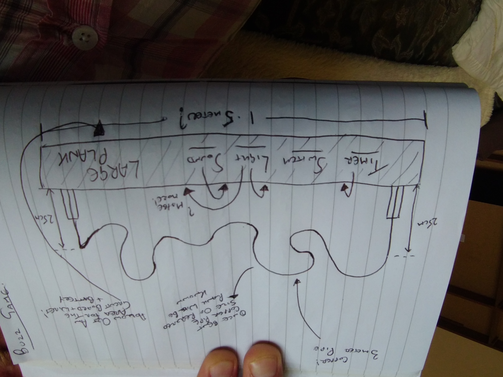

That Sketch is brilliant Bernard thank you will definately help me in understanding what I need to be doing but beginning to realise how much I've taken on lol... I'm never one to do anything by half though.
I've been looking for where I can buy the parts I need and found this website... Any chance you can indicate what it is I need to buy?
http://www.modellingelectronics.co.uk
Alot of the terminologies that you use are above my head but I am learning :)
On n Livewire... I have some programing capabilities.. Is what you suggest expensive ?

I made a few changes & added time remaining clock. SW, SPDT bat handle toggle switch; off or " Ready ", resets every thing; on, " Start ", starts the clock, all LEDs on & strike LEDs 1-3 on. Clock LEDs go off one by one left to right every 2 sec. If no more than 2 strikes are recorded & clock times out then the strikeout alarm
, U2, sounds & flashes If 3 strikes are recorded The alarm sounds for about 2.5 sec.
If time is running , no strikes & loupe hits end of travel sensor, S, then home run ckt. U5, is triggered causing clock oscillator, U7, to go from 2 sec. to .06 sec,/ step or about 1 sec. for full sweep. TBD, to be determined
any additional LEDs etc. If a strike is recorded, then the home run ckt. is inhibited.Steady Hand 3 00000.jpg Steady Hand 3 00000.jpg
