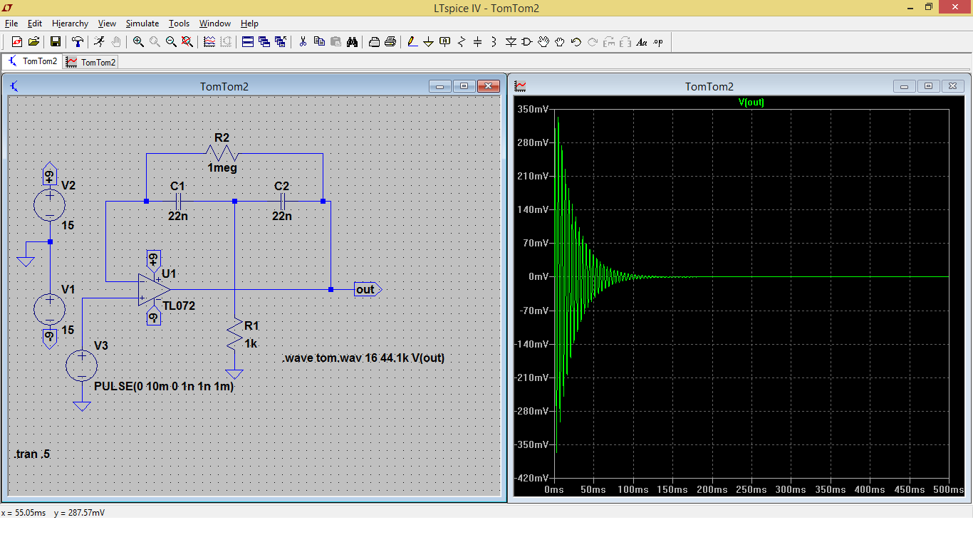

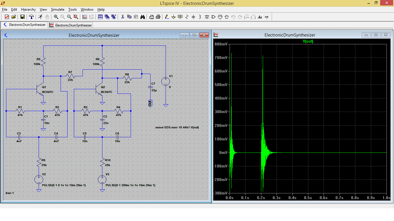

If you are interested in Drum synthisizers...
Here are two drum schematics I found somewhere on the web sometime ago. One is for a tom tom but with some tweaking you could probably make it sound like a bass drum or a bell. It only has 5 components so it´s easy to breadboard (yet I've never done so myself :rolleyes: ).
The other one is actually two similar circuits and they sound like two bongo drums or a single bongo hit at two different places. Like the other circuit you can with some tweaking probably make it sound like a bell or a bass drum as well. I've only made a simulation of it but the bongo sound was surprisingly realistic.
And if you have LTspice I included the asc files.
