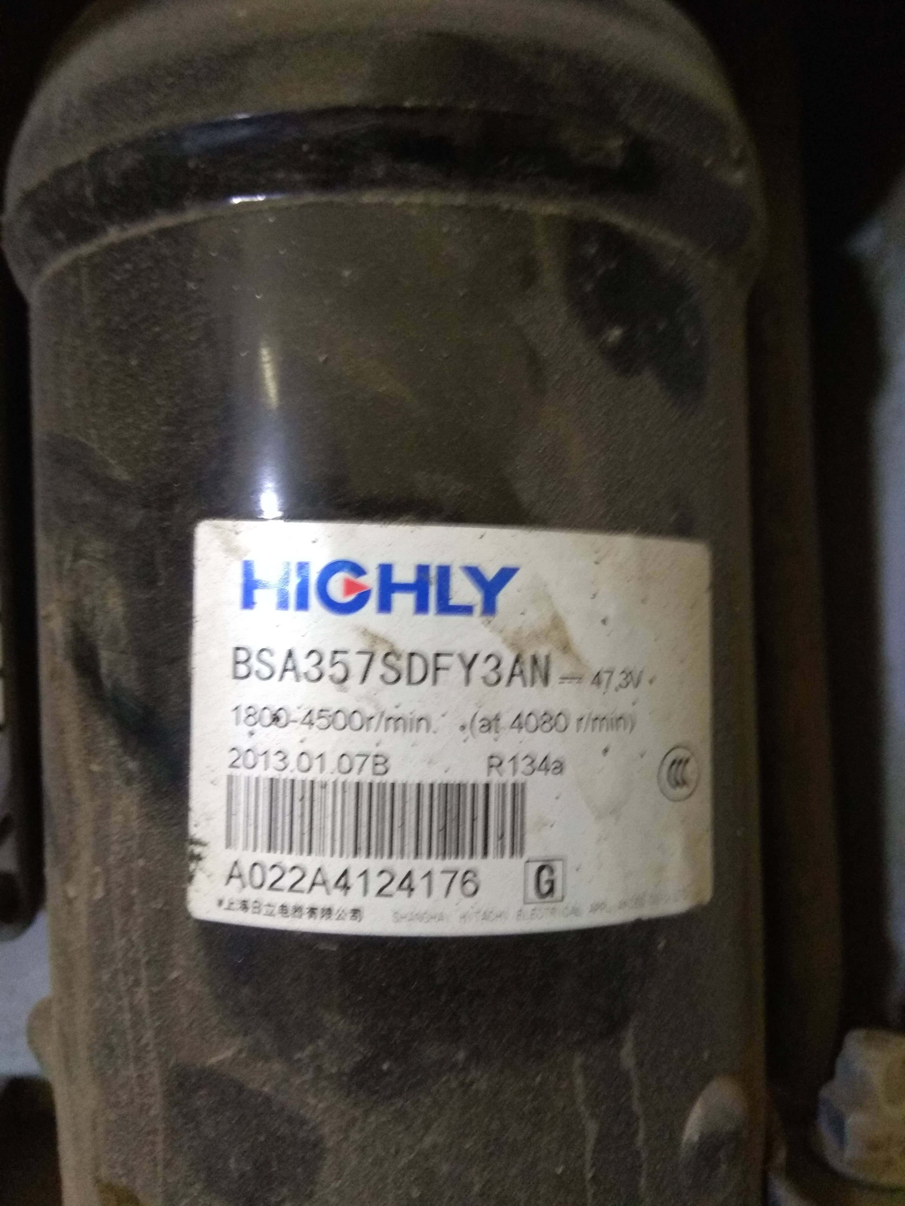

I want to control an DC Compressor which have a BLDC motor in it but only 3 wires are coming from it, even the motors that are being used for RC purposes have 3 wires and nothing more, so that is what making me confuse.
Are you sure it's a bldc motor, and not a 3-phase induction one? Do you have a pic of the motor and its plate?
This is the motor and according to google it is a rotary compressor, but all the circuit that was originally driving it is seems to be BLDC driving circuit with Mosfets and all.
MaxHeadRoom
Joined Jul 18, 2013
30,661
Seems to be a Oriental company making BLDC HVAC motors, many or used now for HVAC fan control such as the GE ECM motors, even the main motors in washing machines, such as the Fischer-Paykel outrunner.
Most of these do not use any physical rotor sensor, but sense feedback from the effect of rotor position.
