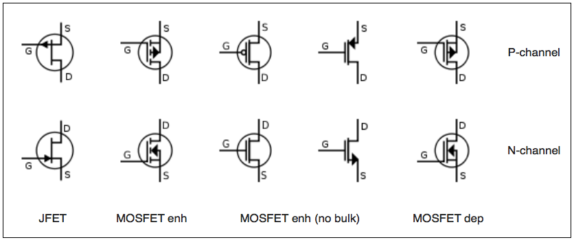

your MOSFET-s look like bottom-right enh (no bulk) --e.g.-- an n-channel ones
if you use both p-ch. -- your design goes that much more simple that you need no supply over the 18V
but that also requires checking and re-vising all specific situations as no battery , evt. insert , evt. remove ... re-biasing the op-amps ...
everything (topology) can be made to work but some require loads of more control circuitry than the others
i'm not attempting to change your design . . . just mentioning the possible alternate options . . . (there's no much point to design your own charge controller from multiple parts ... when theres a commercially avail. and tested in singe iC . . . unless it doesnot do exactly what you intend ... or want to learn to make one yourself ...)
