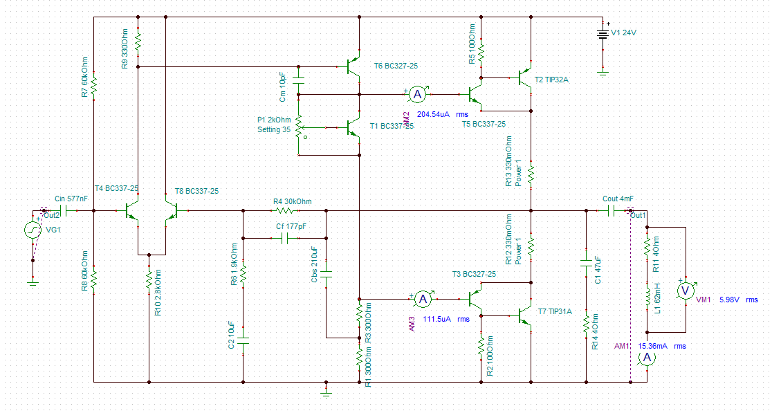

hi guys, so i've been playing for a while and the simulation works is pretty much working as expected :D somewhat elated as 3 days ago i didn't think this would happen ^^
main issue is i'm getting some peak clipping when input signal goes above 400mV peak, which is about 6V rms at the output. anything above this clips.
im pretty sure this is just as its reached its maximum output voltage so is behaving as would be expected. when its not 3 am ill go grab a calculator and check that it has reached its peak voltage and current limits, but at a glance it seems like it.
i'd like to be able to use it with consumer line in products which would make the input peak voltage about 450mV. Is this just a case of recalculating with a gain of say 18 so as to allow for a slightly larger input signal?
have attached an image of it clipping at a 7.46 rms when a 1v pk-pk signal is input, its using calculated values on the caps at the moment as i was playing around to see how changes affected bandwidth etc. ignore the slightly peculiar waveform, its a particularly old and inefficient simulation package that always gets a bit funny with the scope on, the weirdness on the first peak is just it starting to redraw the curve.....

will do some research as soon as i've got time, got another assignment to finish off, but that shouldn't take too long. i'm assuming i will need to do some recalculations once i've added it due to increased load impedance.
peak clipping of larger input signals was an easy fix, just raised the resistance of r6 in the diagram above to about 1.8k and it all seems fine :D

Coollestersmooth can you tell me where I can buy a 577nF, 210μF, 177pF, 4000μF and 60kΩ resistor ??
You never heard about "standard values"?
For resistors use E24 series
E24: 10 11 12 13 15 16 18 20 22 24 27 30 33 36 39 43 47 51 56 62 68 75 82 91
And for capacitors E6
E6: 10 15 22 33 47 68
As you can see 577nF don't exist, you can buy 680nF or 470nF as for 60kΩ use 62 or 58 etc.

just wanted to check i have calculated my zobel network right.
4 ohm speaker impedance, voice coil impedance = 0.62mH (taken from speaker datasheet).
z = R + XL you can calculate through but Xl is neglegable at all frequencies 10Hz-20Kz
therefore Rs=Rz≈4 ohms
Cz= Ls/Rs^2 = 0.62mH/16 = 3.875 x 10^-5 ≈38uF ≈47uF (nearest available)

hmmmm, so doing some modeling for the circuit, adding in the inductive part of the load massively reduces current at the output. :S
currently modeling with a resistor in series with an inductor for the load impedance (rough approximation of the speaker)
current has dropped from about 1.75A to 15mA! im imagining this is going to cause problems?
not sure if my zobel network is correct either, i think i may be missing a resistor connecting the load impedance to before the output pair ala R3 in figure 27 of studiots post above (post #147)

so with the zobel network in place most of my current is dropped across this.
without it it just cant drive the load impedance to the required current. phooey.

herpaderp, as we all know, i'm an idiot
simulating with 62mH not 0.62mH
current is back up to 1.08A
still dropped a significant chunk of my output power. not entirely sure how to compensate for this.

just spotted my collosal cock up in zobell calcs,
xl=2 pi f L not L =2 pi f Xl
