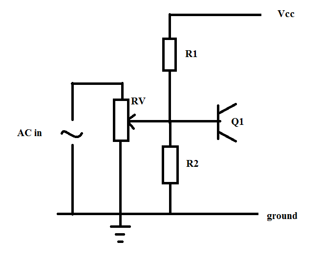

so im working through the calculations at the moment, i am just calculating Rin and am wondering, if i plan on putting the input through a 10k variable pot to ground for volume control, this would need to be aloud for in my calculations for Rf1? my gut instinct is leaning towards no since at max output this resistance is 0 Ohms
something like this:
if i am to consider it Rin would become
Rin = Rv + R1||R2
#12
Joined Nov 30, 2010
18,224
Which drawing are we working with now?
What happened to the differential pair? If you use a differential pair for the input, the gain control feedback circuit is safely separated from the input signal.
Coollestersmooth
Joined Dec 18, 2014
72
this was just tacked on to the front of the previous circuit, was just a quick sketch up trying to add volume control. q1 in that image would be q1 in post #114 in which jony stated that
R1 = R2 = 0.5Vcc/(10 * IcQ1/Hfe_min) ≈ 10V/0.2mA ≈ 47kΩ
Also notice that R1||R2 determine the amplifier input resistance. Rin = R1||R2 = 47kΩ/2 = 23kΩ
And to reduce the "DC offset" RF1 should be equal to Rin
RF1 = 22kΩ
#12
Joined Nov 30, 2010
18,224
True, but this is a DC consideration. Use a capacitor to couple the input signal to Bq1 so the volume control does not affect the DC drift rate.
Coollestersmooth
Joined Dec 18, 2014
72
like this?
in a similar vein. the value for that capacitor is calculated at 5.33x10^-7F
i have assumed i am using a 1 uF cap as good 50V electrolytic caps aren't available any smaller, think at should be fine as rearranging gives a lower freq at about 5 Hz

#12
Joined Nov 30, 2010
18,224
like this?
Yes.
Use a metal film capacitor.
I get 0.17 uf for -3db @ 40 Hz.
