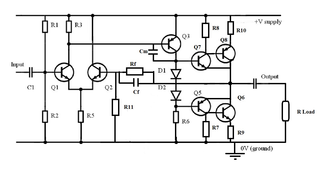

hi all, back to trying to build my amp, other assignments took a while longer than i would have hoped.
trying to get my head round sorting the positive/negative feedback, i understand what your saying but have seen a few schematics for three stage amplifiers that are similar to the sort of thing im trying to achieve.
Infact most 10 watt amp schematics i've seen are 3 stage and feature a long tail pair for feedback.
For example:
From what i can see this would also mean that the feedback loop would be inphase with q1's emitter at the emitter of q2?
yet this is a tested schematic so i assume it works, am i missing something to do with the sziklai pair?

Yes, the feedback path must be in phase with the input signal to accomplish diminishing the voltage gain of the differential pair.
For a moment, in your mind, ignore Q8 and Q5. They are slaves to Q7 and Q4 and do nothing except enhance the current flow.
If the input voltage moves more negative, more current flows through R1.
More current through R1 means more positive on the base of Q3.
More current through Q3 means more current through Q4 and the output voltage moves toward less positive (more negative).
Feedback more negative voltage to base Q2 and you have accomplished negative feedback.
What is the question here?
R8/R4 forms the feedback resistor divider and is fed into the base of Q2.
The output to the next stage of the longtail pair is taken from the collector of Q1 which is in antiphase to the output of Q2 collector.
The output of Q2 collector is in antiphase to the output of Q1 collector and to the input at the base of Q2.
So the output of Q1 collector is in phase with the feedback input at the base of Q2. (see edit)
Edit
I should have said the output of Q1 collector is in phase with the % output fed back to the other input of the long tail pair.
Of course the input to the amp is to the base of Q1 and therefore in antiphase to the collector of Q1 and therefore in antiphase to the feedback.
So the feedback is negative, as required.
Do not compare the emitters of a long tail pair as they operate in antiphase to maintain the constant current in the tail. Both are doing their (opposite) thing at the same time into the same load. The collectors, however are separate and therefore can be considered separately.

i think i get what you mean, i was thinking along the lines of if there in phase at the emitters then positive voltage + positive voltage = greater positive voltage, silly me ^^ it makes sense when explained like this.

added an output pair, am i right in thinking i need some arbitrary small value resistors in r9 and 10 to stop damage with continual output? any other thoughts/suggestions? still not sure what to do about balancing the positive and negative output cycles with regards to R6, is it likely to affect my output massively? id ideally like to avoid using paired transistors for bias currents and keep that as kind of an optional upgrade for if i have time/things are going well.

Emitter resistors R9 and R 10 are usually less than 1 ohm, but will need to be power types as they carry the output current.
Here is the classic Texas Instrument amp of this type from their manual.
They use this configuration to create amps from 10W to 30W.
The circuit description and the whys and wherefores of the design decisions are quite illuminating.
Note the amplified diode transistor VT4 instead of bias diodes D1 and D2 that you have. This allows setting the bias to optimise low level distortion.

makes sense, not entirely sure i understand why its wired up between c7 and r17, come to think of it R17 seems a bit of an enigma altogether, i shall have to see if i can dig up a copy of the TI manual. I have been thinking that there is a distinct lack of trim in my current circuit....

RV2 and VT4 are an adjustable spacer. They compensate for the Vbe cost of the driver transistors VT5 and VT6. You use them to set the idle current through R15 and R16. Then attach VT4 to the hottest place you can find on the heat sink for VT5 and VT6.
