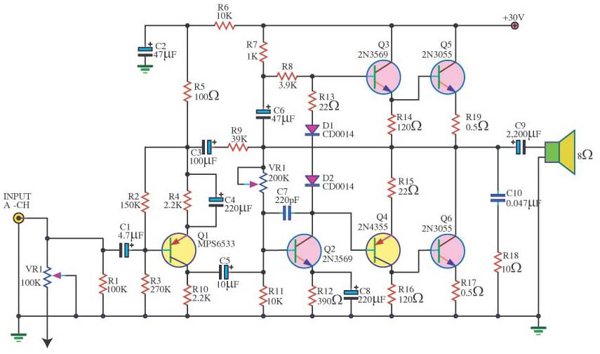

Hi everyone,
Thanks for the feedback. i can assure you no offence was taken, i need all the help i can get. If anything i get annoyed at myself for making mistakes/asking questions i know to be stupid, due to lack of experience.
I studied acoustic engineering for a year several years ago and have now started on a HNC in electronic engineering.
I have some understanding of the basic principles behind transistors, however i have never put this into use before and have only really dealt with single transistor circuits.
I'm attempting to build a transistor based amp for my project, however it is probably above the level of detail we study transistors to, so I'm having to wing it and research etc to find out more.
Whilst I'm aware that i can just get a schematic, and that there are probably better ways of implementing my ideas and better components for the job, the general idea was to gain a bit of understanding into the use of transistors within amplifier design, the amp itself isn't expected to be anything spectacular.
To be honest I'm in over my head but I'm determined to get something working if it kills me. ^^
i haven't got a circuit diagram with me, but the basic idea is something along the lines of this.
its going to be very very basic. just to get an idea of design really.
I have a max supply voltage of 30V however was actually looking at dropping this to 20 odd as this should be more than adiquate.
The idea is -Q1+2, input pair, minimal gain (unity or maybe 2)
-Q3 VAS, most/all of my 20x voltage gain
-Q4+5 output stage, supplying current for the load.
I've been researching but am struggling with getting small gains at the input pair.
A random example.... (not any of the values i've used, I'm out of town at the moment and haven't got them on me)
Calculating gain.
(C1 = R3, C2 = R4 from the circuit above)
gm = 1 mA / 25 mV = 0.04 A/V.
single-ended gain:
Therefore gain can be altered by adjusting the value of R3 + R4 in the circuit above.
but for unity gain there values would be very small (100 ohms region)
Is this not going to give massive currents at the collector?
what can i change to alter gain without affecting biasing etc?
many thanks in advance,
Will
Jony130
Joined Feb 17, 2009
5,601
Well the input stage gain is
Av1 = (R3||RinQ3)/(2*re)
Where:
RinQ3 = (Hfe + 1) *26mV/IcQ3
re = 26mV/IcQ1
Also do you know the difference between open loop gain vs closed loop gain ??
Also do you know that if you design the circuit properly the voltage gain will be equal to R8/R7 ?? And for single supply you need a capacitor in series with R7.

I think I'm naming a specific here. Gm is not in the first stage gain equation, right after you make the negative feedback loop with R8 and R7. Excessive gain that you are not using is what reduces distortion. Let the input pair run free and quench the excess with R8 and R7.

so your saying i set the gain for my input pair higher (without feedback) then the feedback attenuates this to the levels i want (which i can set by varying R7 and R8) whilst simultaneously reducing my distortion.

I understand the difference but haven't really considered its implications in my design so far, its all been trying to get to grips with the gains.
i was under the impression that if i aim for an open loop gain of around 20 and then make my feedback resistors give around a 20th of this to the base at Q2 i should get something approximately equal to the gain I'm after?
No wrong . Why you want Aol -open loop gain equal 20V/V ? And in real life we want the open loop gain to be as large as we can get.
And then we can set Acl - closed loop gain at 20V/V.
Acl = Aol/(1 + Aol *B)
where
B = R7/(R8 + R7)
So only if Aol >> 1/B the closed loop gain approaches 1/B
And this is why in real live we don't care about firs stage gain. Because in this type of a amplifier Aol is mainly set by Q3 voltage gain.
so i can calculate Rinq3, set re to give the current i want at the emitters and then vary R3 to get the gain i need?
Yes, but this will not be easy, because the voltage droop across R3 is almost constant equal to VbeQ3 = 0.66V, so IcQ1 ≈ VbeQ3/R3 (I ignore Q3 base current)
are you saying I'm going to have problems with transistor saturation at values way below my desired output voltage?
Yes, exactly

If the base of Q1 receives a positive going signal, the feedback loop will raise the base of Q2 to almost the same voltage. (If the base of Q2 was raised to exactly the same voltage, there would be zero gain in the differential stage.) The lack of raising the base of Q2 to exactly the same as base of Q1 is what allows some gain in that stage. The gain will be exactly enough to drive the following stages to a high enough voltage gain to drive R7 and R8. Thus, the bases and emitters wag up and down on the oscilloscope screen, but the voltage across R3 changes very little.
