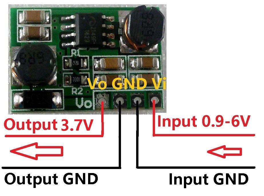

This would be a good bet .
I'm sorry I first put the NPN as follower
Wow! be80be above and beyond. I'm humbled and very thankful for the effort you've been going to here. Thank you so much.
Let's see if I've wrapped my brain around this:
Two AA batteries which will ultimately power the glow plug when the relay is turned on.
The same AA batteries run through a buck/boost? converter which I presume lifts the voltage to 5 volts to power the ATTiny.

You maybe can find a small relay that has a 40ma or less coil in 5 volts but there's lot's of small 5 volt 5 to 10 amp relays in the 40 to 100 mA range you could try a MOSFET for the relay but I would stick with the relay.
Why because it's not going to take away from the current output of the AA battery .
The transistor is a switch to let you use most any relay in the 40 to 200 mA range.
https://www.aliexpress.com/store/pr...V-4-5V-to-5V-Voltage/1525466_32409755078.html
There's better one's then that one just posted it
Just make sure you get a .09 to1.5 volt to 5 volt booster

OK, be80be, I'm going to get the booster, a relay with a 5v coil and at least 3A max contact current, a basic NPN transistor, try it all out and report back.
Are the capacitors in your schematic 0.1uF?
I'm very hopeful about this, be80be, thank you again for your help. It will take some time for me to source the components where I live but as soon as I have them, I'll report back on how it goes.

If that's the situation then you are right and better stay with the AA, and be80be's solution looks good for you - but just know you can use any boost converter that outputs a voltage between 1.8 - 5.5V (attiny85V recommended supply voltage) and accepts input voltage of 1.5V. also notice the maximum current/power the converter can output.
be80be
Joined Jul 5, 2008
2,395
The one I linked is 480 mA most are that much I'd boost to 5 volts cause the relays easy to find.
Power the glow plug at it's 1.5 you be good to go.
