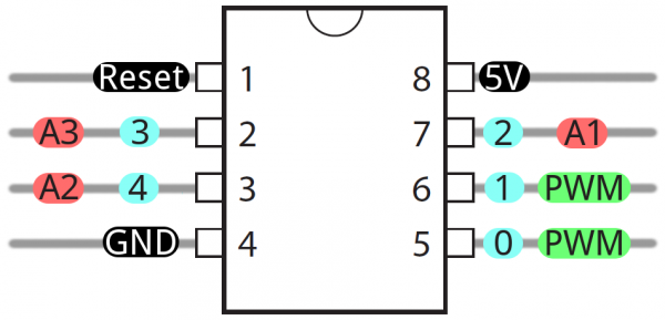

I'm using the Attiny13, 1K flash
from datasheet:
No schematic needed... it's just VCC and ground then the 3 outputs.
I have outputs from pin 5,6,7 going to anodes of LED, they are running two each parallel but each have own resistors.
using this cheapo regulator... it's an AMS1117 5.0 with the filter caps... and a 12V supply.
from datasheet:
Thanks for your reply. I’m sure that I’ve duplicated your work, but the good news is that I agree with you. It should work.
Have you ran the power module standalone and see what you’re getting for it’s output? Just to confirm that it’s operating properly.
And I am still wondering if you’ve checked the output resistor values? Your symptoms could be explained by one or more pin outputs with a too small resistor.
