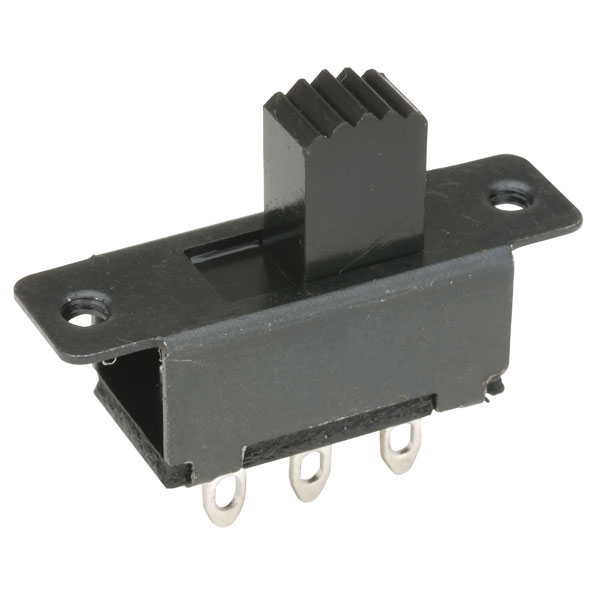

Here's the deal. I want to use a switch or make a switching circuit which switches 3 different wires at once. The switch that I'm thinking of is a slide switch as this:
However, this switch only switches 1 wire. I happen to have a similar slide switch which switches 2 wires but I can't find any 3 wire switch. Solutions related to the usage of ICs as analog switches are also welcomed!

The switch you show is a Single Pole Double Throw (SPDT) switch. Switches are listed in terms of how many circuits (or poles) may be switched (throws).
For three wires, on and off, you need three poles single throw, or 3PST. I searched DigiKey for these. I did not find any 3PST switch, but a 3PDT switch will also work, you just don't use one of the poles.
DigiKey Parts.
