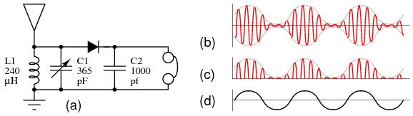

Using one of the illustrations I'm going through how one of the other concepts taught beginners is a bit off. Again, it is so useful it will never go away.
http://www.allaboutcircuits.com/vol_3/chpt_9/6.html
Here we are shown that we rectify the RF, and the varying amplitude spits out the audio. Jives nicely with varying amplitude RF carrier wave theory, doesn't it?
But try looking at it another way instead. The carrier wave is being heterodyned by the diode with the side bands. Given the difference frequencies are the audio, audio out is what you get.

I think one could readily recover the modulating signal using a simple envelope detector. I don't think you would need to re-instate the 'missing' sideband in a typical bog standard AM receiver.

Amplitude modulation is the modulation of an AC signal by an AC signal with different frequency.
This seems pretty... useless. The fact that the word "modulation" is used both as part of the definition and as part of the term being defined makes it circular. Unless the definition is specifically saying what the "amplitude" descriptor means. But, in either case, this implies that FM, PM, and any and all other modulations schemes are NOT the modulation of an AC signal by an AC signal with a different frequency.
WBahn
Joined Mar 31, 2012
33,089
One of the reasons I dispute the model where you vary the carrier amplitude is the carrier does not actually vary amplitude, it is the sidebands that do all the varying.
But this is pure semantics. If I pass a signal through an amplifier that have variable gain and I reach over and turn up the gain, have I not varied the amplitude of the signal? If I sit there an turn the the gain up and down in response to the beat of the music, am I not varying the amplitude of signal? If I hook up a circuit that varies the gain in response to the signal coming from a microphone as I speak into it, am I not varying the amplitude of the signal? Whether you speak of the variations imposed on the amplitude of the signal as creating the sidebands or you talk about the sidebands (spectrum of the signal controlling the gain) varying the amplitude is six-to-one half-a-dozen to the other (each description has merit and value).
A statement was made that AM is not linear, in an ideal system I would dispute that too. The sidebands are spectrally identical to the audio.
But you can only move the audio to the sideband of the carrier through a nonlinear process. In your first post in this thread you talk about a 1MHz signal and a 1.001MHz signal and how that produced the same spectra as mixing a 1kHz signal onto a 1MHz carrier. Leaving aside the other sideband, the question still remains how you got the 1.001MHz signal from the 1kHz signal to begin with. It had to be through a nonlinear process because linear systems can only change the amplitude and phase of frequency components in the signal, they can't produce signals at new frequencies.

I would base the statement on the general AM function of the form
\(f(t)=\(1+msin(\omega_m t)\)A_csin(\omega_ct)\)
where m is the modulation index.
The effective RMS value of f(t) for various values of m varies but the carrier RMS value [at frequency ωc] remains unchanged. Only the total sideband RMS value changes in response to changing modulation index.
Fraid not. The fact is, if you measure the carrier it does not vary. If you filter the sidebands out you will have a steady state signal. This is more than semantics, this is a reality.
The act of modulation, which is what you are describing, creates the sidebands. This is the reality. The act of modulating a RF carrier is pure heterodyne. You are creating new frequencies, this does not mean you are modifying the old ones in any significant manner.
The reason you can suppress the carrier, or reject a carrier, is because they are separate and distinct signals, so you can pick and choose among them.
A spectrum analyzer is a piece of test equipment that measures exactly that. So is a selective voltmeter. Interestingly, they are modified AM radios. On the shop floor the techs would take selective voltmeters and configure them to be AM radios, before I figured out what they were doing it would puzzle me where the audio was coming from.
When we build things like transmitters we are trying to get as close to theory as we can, anything else is distortion. Mathematically though, a signal that is slowly cycling has a sideband, and what you are actually seeing is an interference pattern. I am not well versed in Fourier Analysis, but as I understand it this is pretty much the basis for it. Any repeating waveform, be it AM modulation or a triangle wave, can be broken down into many steady state (constant amplitude) frequencies.
If you have a amplifier whose gain can be varied electrically, up to 20Khz, you have an AM modulator. Interestingly, you also have a precision heterodyne circuit. You can not separate the two.

If it is as you explain, Bill, calling it AM (amplitude modulation) is deadly wrong. No amplitude is changing here...
And how is then, they get this in the scope?
Which is what I've been saying. You're the one who has been claiming that AM modulation is the linear addition of the sidebands.
Which is a nonlinear process.
Which why it is semantics to say that one description is wrong and the other is right.
