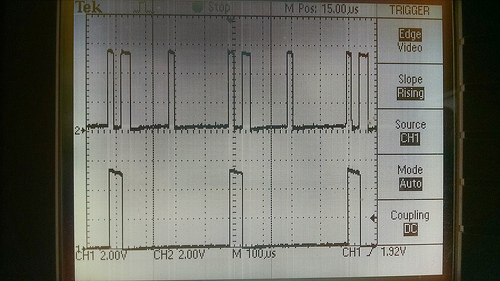

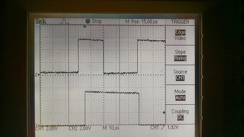

ADC interrupt timing with TIMER4 interrupt example from the below code:
Top trace: HIGH processor in high ISR routine/LOW in main or low pri ISR, triggered from timer 4 interrupt.
Bottom trace: HIGH ADC conversion time triggered from the timer 4 interrupt and back to LOW at the ADC conversion complete interrupt.
Repeated interrupt sequences with a timed (timer4) ADC sample every ~400 usecs into a data buffer.
https://github.com/nsaspook/pyro/blob/master/p18pyro.X/pyro_vector.c
All of this is happening in background within a program with lots of other processing from main.

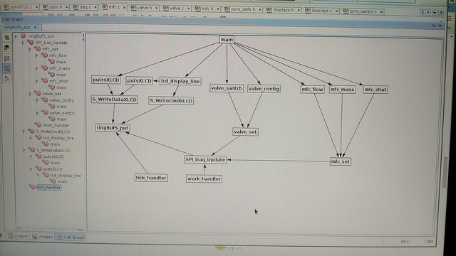

MPLAB X code call graph for routine ringBufs_put.
