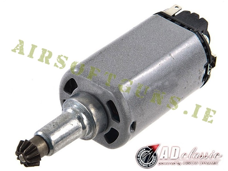

The battery is an 11.1V 2200mAh 30C LiPo hobby battery. The surge measurement is an estimate based on a computerized multimeter a friend of mine has.
The Motor is not 385 Watts... It's one from this company ( http://www.chaolimotor.com/EN/product.asp ), pictured foremost in the banner, but I cannot find it in the catalog. It is the standard stock Airsoft motor you find in most china-made replicas.

http://www.airsoftguns.ie/2857-thickbox/ad-classic-aeg-standard-motor-long.jpg

Concerning amperage, I know for a fact that the gun pulls a sustained 2A-35A draw depending on the position of the gears. I also know that the Battery can safely put out a maximum of 65A for an extended time, though the charge will not last long in that situation. This is a very powerful gun, hence the need for the MOSFET in the first place. Without it, we get major arc burns, rendering the trigger switch useless after only a couple dozen pulls.
