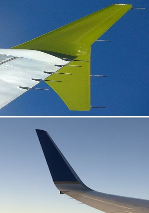

found some pics of the trailing edge. i think this is what @Marley was talking about. does anyone know the actual name of these sharp rods. thank you :)
The terms, "static wicks" or "static discharge wicks" are commonly used. Also, mostly high speed aircraft have electrical bonding between movable surfaces and the main airframe.

Those static discharge probes are typically sharp points. Electrons can more easily escape from a sharp point than from a blunt point. The purpose of those static discharge probes are for discharging static that is otherwise generated by dust particles in the atmosphere. Upon landing, aircraft can have a lot of static charge built up. Those probes reduce the static but do not completely discharge the static. If you've ever watched a plane being refueled, the fuel truck (if no under ground fuel piping is available) is first grounded to earth. Then the plane is grounded to earth. Then the fuel cart (with underground piping) is grounded to earth. THEN the fuel cart (or truck) is grounded to the aircraft. THEN the fuel hose is grounded to the wing of the aircraft. THEN the fuel door is opened and the fuel hose can be connected. One spark can set off a catastrophic fire. All because of the airplane bumping into dust particles in the air. There are other sources of static generation as well, such as charging that can occur simply by proximity to a thunder storm. Even if the plane isn't hit.

thx a lot. i just googled it and found many examples :)

in every incident the lightning bolt enters from the front part of the airplane and then exits from the trailing edge where static wicks are located. may be it's due to the shape of the front part which attracts the lightning
