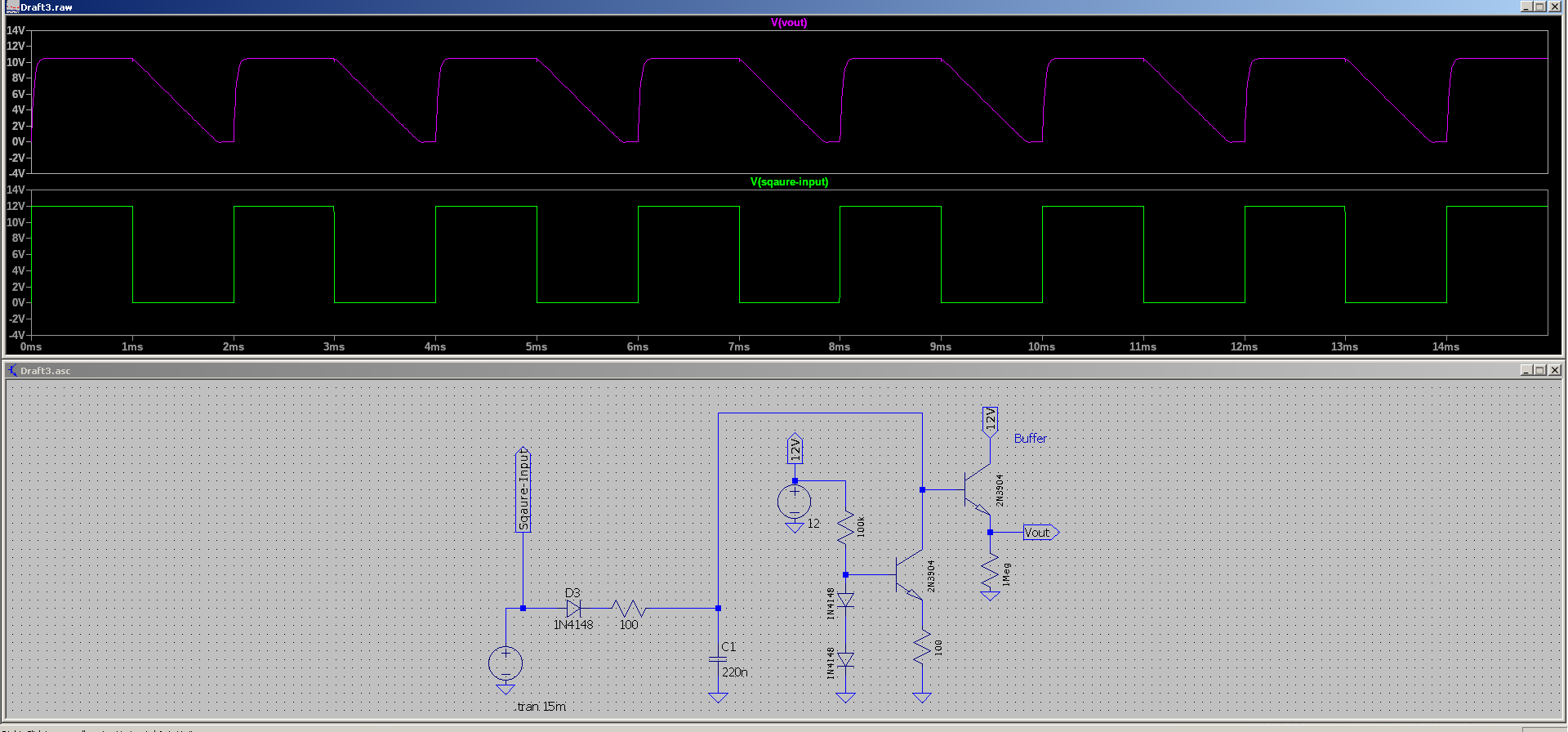

The MMBT3904 is for a constant current source for the capacitor to discharge make the linear falling edge.
Would a gate driver correctly output the falling edge into a MOSFET gate?

If the question is - can a 3904 be used to construct a constant current source that will discharge a capacitor for form a linear voltage ramp, the answer is yes - BUT -
A constant current course (CCS) circuit needs an operating headroom of at least one base-emitter voltage drop (Vbe). With an NPN transistor and the emitter tied to GND, the linear part of the output waveform would stop at approx +0.6 V.
AND, because it is a current source circuit, the output impedance will be high. A load of even 1 mA will distort the linearity of the waveform.
A cure for both of these issues is bipolar power supplies powering an output buffer.

There is no distortion on the output. Is it just a spice artifact?
What load (resistance, capacitance, inductance) must Vout drive while maintaining the rise/fall times you spec? For example, in your schematic, Vout will fall more slowly as the load capacitance rises.

The 100 ohms input resistor quickly charges the 220nF capacitor but the 7mA current source slowly discharges it producing a falling ramp voltage.

That is indeed what is expected at the base of the final 2N3904. It is not what will be seen at the emitter of that transistor IF there is any significant capacitive load. There is no active pull-down at Vout, only a 1Meg resistor.

Of course the 1M emitter resistor has a very low discharge current. I was even going to mention the capacitance of the transistor plus stray capacitance.
