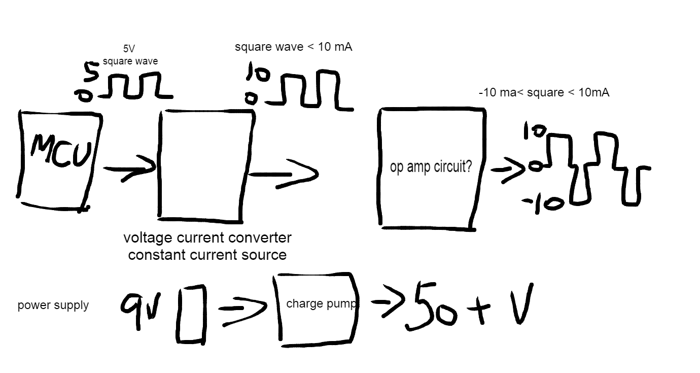

For constant current source, i am using a circuit
Vcc should be 50+.
then in order to induce least voltage drop across R3,
V+ going to to opamp, which was originally 0-5V square wave, should be amplified to 0-40+V, then go to opamp?
can opamp amplify to 40+V? because I think most opamp have Vcc limit around 30V?
Also, is possible to convert 0-10mA square wave to +- 10mA square wave?
for charge pump I am thinking about using IC from linear technology or maxim.
is possible to boost from 9V to 50+V?
Can anyone verify if my logic is correct?

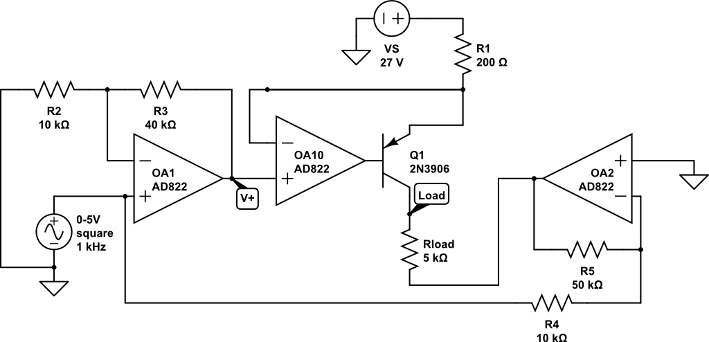

I developed a schematic which is able to produce 50V across VLoad, with constant current of 10mA at max 5000 ohm.
since AD822 is limited by 30V, I use opamp1 produce 25V and opamp2 produce -25V to give 50V.
Is solution correct?
And now is +10mA, how do I get -10mA?
Also, can current flow in both direction across VLoad? because I thought current must flow away from collector of transistor.
Thank you.

blah2222 has some good points. Your output is getting close to 60 volts. That sounds high. How do you know that voltage that high cannot cause damage, even when current limited to 10 ma?
How much voltage and what current limiges do commercially available stimulators use?
I'm glad you are thinking about how to protect the user in the case of failure of the current source. A good solution might to be to use enough resistance between the voltage source and the electrodes so that an unsafe current cannot be produced. Alternatively, you could have a current monitor that shuts down the circuit when a specific threshold is crossed.

Another thing to keep in mind is that the load is not purely resistive as you have assumed (see http://soundlab.cs.princeton.edu/learning/tutorials/sensors/img29.gif). Your design will not work as you expect with that assumption.
When you apply a square wave pulse of current, the voltage will ramp linearly due to the capacitive element of the load. A simple approximation would be a resistor (few hundred ohms) in series with a parallel resistor-capacitor combination.
Stimulation frequency and duty cycle are also very critical here. Your on-time shouldn't be more than a few hundred milliseconds as that can get quite uncomfortable for the user and increasing the frequency past 40 Hz starts to get uncomfortable as well.
Based on your current design you have no mention of pulse duration or frequency of stimulation at all, which besides current amplitude are pretty darn important. You also don't seem to be aware of what kind of load you are dealing with. I would recommend that you sit down and read up on electrical stimulation and bioelectricity if you are planning on moving forward with this.
Final thoughts, why are you wanting to stimulate the wrist? At most that will create an awkward movement/tingling of the fingers. I am interested in your goal here...

I also find resistor capacitor representation of skin.
But I am confused.
What do you mean voltage will ramp linearly due to the capacitive element of the load.
You mean I should use a resistor capacitor load instead of a simple varying resistor to simulate as skin resistance to provide constant current?
