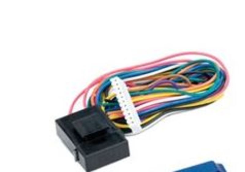

Also, how do I get this from PCB into a plastic housing with fuse breaker inputs and outputs? I want a little ABS black box for it, similar to something like this, obviously without 50 wires, I would have 2-3 wires. I'm just asking how to get it from breadboard to a little module/housing/box?
Entire books could be written on this subject, so I'm not sure I can give you a great, simple answer, but I do have one recommendation for making a more permanent version of the circuit (although they are a bit pricy.) I really like using "perma-proto" boards from Adafruit. They are laid out exactly like breadboards, but with pads for soldering so you can make permanent, reliable connections. The matching layout makes it easier to copy circuits over. There are much cheaper prototyping pcbs available, but I just happen to like the quality and convenience of these. They come in a variety of sizes. Which one you need just depends on how compact you can make your layout without losing functionality. I suspect this project could get down to a "half size" board, but it might need "full."
http://www.adafruit.com/products/591
