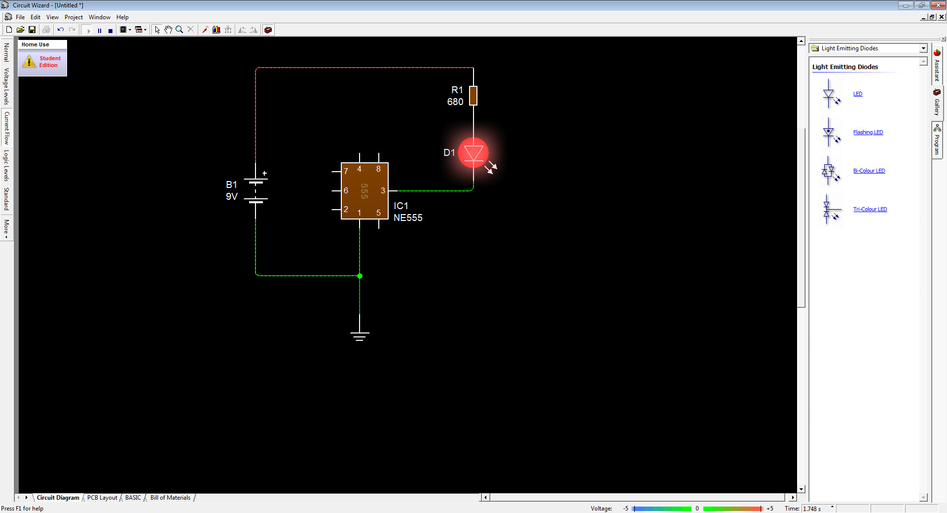

Connect a led through a 680R resistor is series between pin 3 of 555 and ground.
If the 555 is working you should see the led flashing

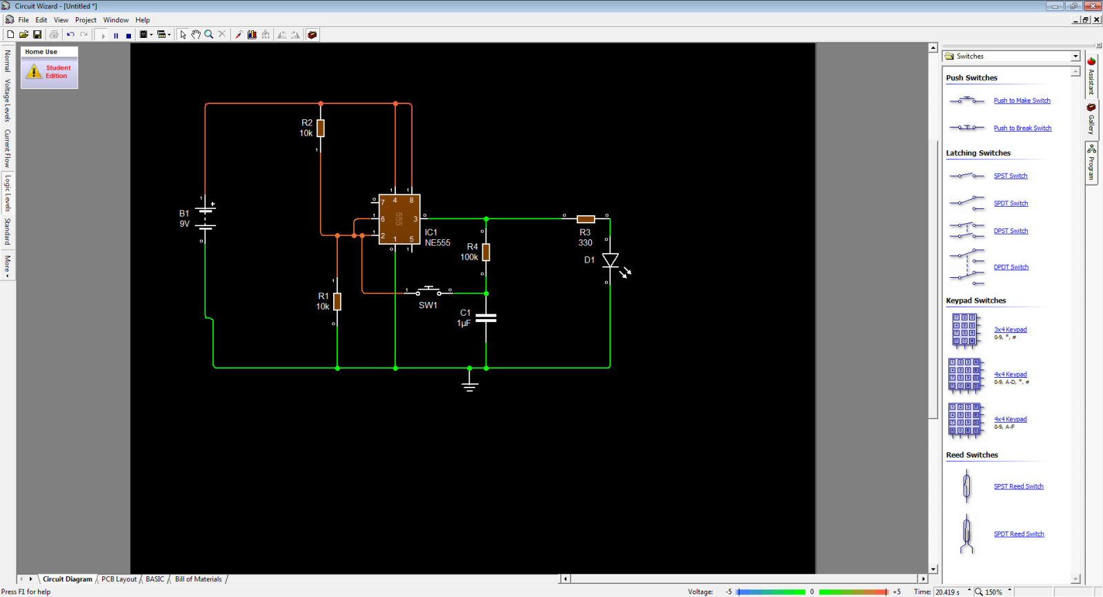

here is what i made in software using this shematic image above.
and it show its works and stays on ,its working good.
testing on software not blinking , am i doing wrong

ok did what you asked here is what has happen.
the led lights up but in way not sure if it blinks or not cause it has this little effect to it like its blinking but not to sure , its like its blinking so fast u cant tell if its steady light or fast blink, its un-noticable rate.
is this what am looking for ? or am i looking for slow blink ever 3 seconds ?
Instead of coming running to us every time you have a tiny little question, try figuring it out for yourself: download an NE555 data sheet and look at the section where it discusses the 555's astable multivibrator mode. Take the component values for your circuit (see post #26 above) and plug them into the formula for frequency (formula 4 on page 11), and calculate the frequency yourself!
There is no need to be peppering us with every little question you have; show some initiative and start thinking for yourself and figuring things out for yourself. Otherwise, people here will quickly run out of patience, and eventually stop helping you.
