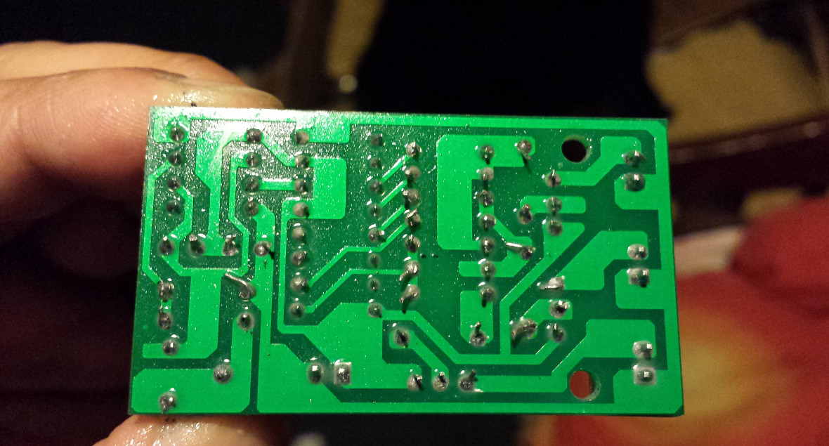

What happened to R5, couldn't you make it fit?
I suspect the (a) problem is on the solder side of the board.
You ask a lot of questions without apparently making any attempt to engage your brain and answer them yourself. Is it easier for you to start a new thread on AAC than to carefully inspect your work or read a datasheet? If you had been bothered to do that you wouldn't be talking about a "programmed" and "non programmed" 555.

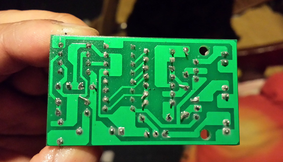

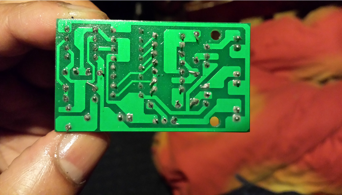

i checked and my solder is fine to be honest otherwise il tell u.
il post a pic again of the back side.
as u seen i fitted the components on the right way , the r5 is fitted and soldered it just got bent i left it as it is.

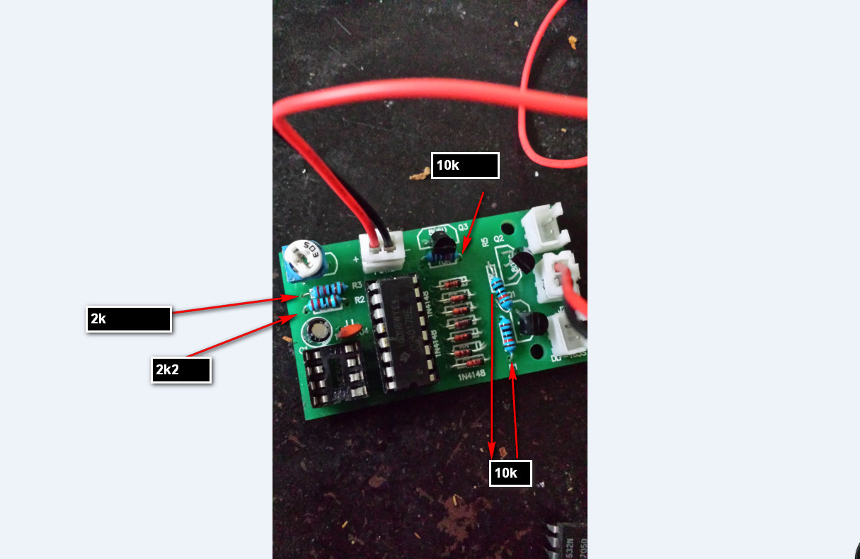

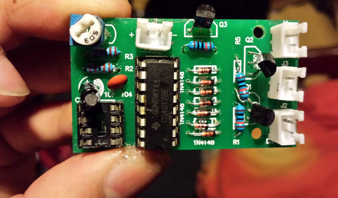

Is the circled pin supposed to be pin 8 or 4?
Is that socket hacked up? Or did you mangle it while soldering?
You need to get some needlenose pliers and a lead former to neaten up the components. If you start by soldering the shortest components first, you can use your finger to hold components in place instead of bending leads. Check the leads you've bent over to make sure that they didn't pierce the solder mask.
a Rob
Joined May 14, 2017
151
the circle u marked is pin 4 sir.
this maybe happen due to inserting the chip but i checked with meter their was no short.
what i dont get is if i leave this socket emty then the board works fine.
but if i insert the 8 leg chip which i have spared but they dont blink i dont know why they tend to heat up ,i end up turning it off before they end up burning out
capacitor is 50v 1uF

hi thanks for the reply.
am aligning the ic marker the top middle curv with the bord markings ?.
if u can se the images i posted above can u check and re-confirm if i done it right or wrong.
a Rob
Joined May 14, 2017
151
ok.
i switched the 555 timer other way around and it dont seem to heat up.
but what i don't get is the marking on the ic chip in middle the round bend and the marking on the clip and the board shows it goes in that direction. but i turned the ic head oposite way around and its not heating up at all.
as u can se the marking on the 8 leg ic on this demo image of some one else
i found NE5532N inserted it both ways around and its not over-heating but its not NE555 ic.
i may need to find ne555 ic and check
JohnInTX
Joined Jun 26, 2012
4,787
You're inserting the timer wrong. That's supposed to be pin 8 and is connected to VCC.
That looks like pin 4 to me. If you look closely at the underside of the board, both IC's pin 1 are indicated by the conventional square land pattern. That would make the notches for both go in the same direction - the notch is the semi-circle at the edge of the chip. The round divot is just a molding artifact. Counting pins on both packages from the square pin 1, you see that the 555 pin 3 (output) is connected to the 4017 pin 14 (clock input). That is what you would expect in this circuit. The image in post #17 looks right.
