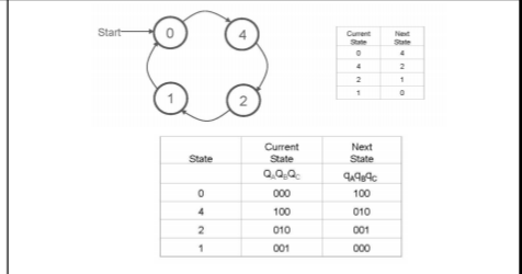

Yes, you only need four states and it only has to be a bi-directional counter (which you said you know how to make). It's generally worthwhile to find ways to turn something you need to do into something you already know how to do. Which is not to say that such a solution is always the best solution -- but it's worth considering. So it might be worth giving some thought about how you might take a two-bit output and produce the specific four four-bit output values you need.
This is how i understand you.
Now i just need to represent my flip flop state
This is little easier example.

That diagram only show it counting in one direction -- you said you needed it to go in both directions. With four states, you only need two flip flops -- which also has the nice trait of leaving you without any unused states. In homework, "don't cares" may be "don't cares", but in the real world, you need to carefully consider the behavior of each unused state in light of what behavior is at least tolerable should the system end up in one of those states.

I'm talking about first example, not about this.

Suppose one needed a 4-color state machine (blue, red, yellow, green) but it was easier to design a state machine with various shades of pink. Then one could just say that pink represents blue, dark pink = red, light pink = yellow, & pale pink = green. But what if the requirement is to see the actual colors? Then one could feed the pink shades into a color changer to get the proper blue, red, yellow, and green colors. Or one could design a state machine capable of producing a broad range of colors, but limit it to selecting only the blue, red, yellow, and green colors (and all the other possible colors would be don't-care colors).
