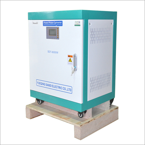

So anyways. What I've been reading is that people are using large 3ph motors to convert 1ph to 3ph. Running 230v single phase in and starting the motor with either a static phase converter or a smaller single phase motor. After starting everything except the 3ph motor is switched off so now the 3ph motor is running off single phase but it is able to have an output on the 3rd leg that was previously not used. Then running 3ph equipment wired parallel off of that. Now I've watched examples of this working but does anyone care to tell me exactly what's happening. It has to be outputting a nice sine wave from what I gather but does it do it nicely 120 apart? I don't understand how you tie into the single phase input and have the phase shift right there. If it is the case can it disrupt back to the mains and cause any other 230v 1ph to be 120 apart vs 180?
Irving
Joined Jan 30, 2016
5,195
A 3ph motor can't start on 1ph without help (i.e a start capacitor) but once running can continue to rotate on 1ph. Once it's rotating the undriven windings, which are electrically at 120deg and 240deg from the driven winding, will individually generate output in the correct phasing. The input power is 1.73 x output power + power to turn the motor, which could be a further 20%.
So for a 3.6kW charger you need 4kW 3ph (say 110v @ 21A/phase) which will require 5kW input, eg 110v @ 45A or 220v @ 23A.
