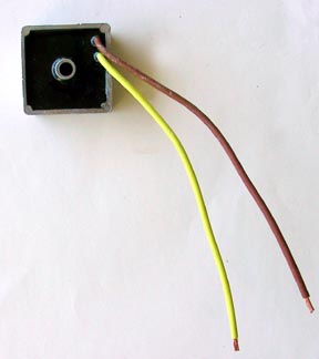

Well, no i cant see any component terminated to the heat sink.
The TO3 case was mounted with 2 secrews and in the screw holes were bushes so the screws cant be tounching the case.
The rectifier was mounted through its center stud. Its also has the wight paste under it but as the case is not part of the circuit this also was no electrically connected to the heatsink.
The onle wires comming out the unit were a black and red wire. These came from the AC terminals on the rectifier. Again not attached to the heat sink. The other terminals of the rectifier went to the zener diode and the transistor.
The other end of the zener joined in with the went to the other terminal on the transistor.
Now when i think about it, the diode and the + wire from the rectifer seem to be connected by the screw through the loop terminal and the threads conduct to the threads of the TO3 case as Solcar suggested. The heat sink is annoddized i beleive which wont conduct electricity.
The TO3 case i am now 90% sure is not electrically connected to the heatsink. The TO3 screws are isolated from the holes in the heat sink by plastic bushes and as the heatsink is annodized the mounting surface of the TO3 could no way be conducting to the heat sink.
The shim between TO3 and heatsink appears to be metallic. Is Mica metallic?

I had another look at my unit in on the black heat sink and i will say i am not 100% i have got the red and black wire (AC connections at the rectifier) the correct way around. As you can see those wires are no longer on the rectifier in the photo. I only went by my drawing i still had which i did 4 years ago when i first pulled this apart. I assume i did it right, but im not 100% sure and i can not remember. That would be the main part im iffy on and perhaps if the anode or cathode of the zener is connected to the transistor. My old drawing says anode connects to base of the transistor so i just assume i got it all right when i drew it many years ago.

Hi Enduro250s, the case of an MJ802 transistor is the collector. Since the cathode of the zener diode connects to the collector in these types amplified zener diode circuits, the the zener can't have a nylon bushing insulating it from the case of the MJ802 in order for it to work.
The heat sink probably is best considered to be at ground potential because the anodizing might get scratched through or the threads of the mounting screws might contact the inside of the mounting holes. But, it is good practice to include a wire from the emitter of the transistor to ground also.
The devices from Jaycar that you linked to are not able to dissipate very much power. Even the MJ802 can only dissipate its fully rated 200 watts if the heat sink is big enough.

I checked again and i can see no way that collector on the transistor is electrically connected to the heat sink. The case mounting screws are isolated from the drilled holes in the heatsink by plastic bushes. I only had the one screw in the loop terminal remaining but i imagine that the other one had a fiber washer under the head of the screw aswell to provide extra security and not rely on the annodizing under the head to insulate the screw from the case. I am 99.9% sure the cathode and + from rectifier (joined in that loop terminal) make electrical contact to the collector via the screw through the loop terminal and then the screw makes contact to the threads in the TO3 case.
There appears to be a couple shims under the transistor. One looks like a silvery metal and i 'think' theres a thin plasticy film jn between the transistor and the metal like shim.
