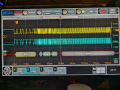

Got a good laugh from this one. I added a extra remote display on my Solar monitoring system via the CANFD 4-wire network (two differential signal wires and two power wires). It's a tee from the other remote display with no termination resistor (R10) on the end of the second remote with a several meter cable run for the extra display.
The DHO does CAN but not CANFD decoding (FD has two bit rates, nominal 1MHz and data 5MHz on this).
Set the DHO decoder to 1MHz bit rate to see the ID header, when it switched to 5MHz for data, this is the scope display try to decode that.
"Stuff" :D
The 5MHz signal section looks fine, with little ringing or reflections.
16,496
