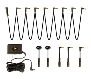

Thanks for taking the time to help. I'm still a little lost.
The network stuff is now all starting to make sense. But I still don't understand grounding.
I won't be running the power through the same cable as it's a bit out of my depth at the moment. I would have thought there would been a power supply like this...
... which is obviously designed for guitar effects and is 9v, but I thought there would be something similar but 24v that could supply power to multiple things. Ribbon cables within computers etc do this also, provide power for multiple devices. Even for 3 or 4 devices would be nice. But I guess it's not essential.
Anyway, my main problem is grounding. But I'm struggling with the very basics. Before I get into grounding shields, how about grounding the connectors.
i.e. Pin number 3 on my Sub-D connector must be grounded. Is this done, simply by connecting a small wire from the pin to the metal chasis? Or must it go somewhere else? Also, as far as I'm aware I should only be grounding one of the connectors, probably the one coming out my PCI express card (Peak CAN interface).
Sorry to have to ask such a basic question, little bit embarassed.
After I understand this, then I'll try and figure out how to ground the shield :D I understand now after reading this following document why it's necessary to ground shielding, but just not 100% sure how to do it. I know you explained above, but if you see my previous question you'll understand I need my hand held. Believe me I've googled it for 2 days, but this basic thing I just can't seem to find online :\ maybe it's the terrible internet at work :(

How you do your grounding will affect network performance and safety. At the moment you appear to be planning on a 24 VDC supply to power not only the transceivers but also the entire nodes, 32 or more of them. See, I don't think you have thought this through because if you had you would relaize that the power demands of 32 node will probably outstrip even a modest size +24VDC power supply. I hope the devices on the network are not planning to use linear regulators because +5V @ 50 mA will make a 7805 get very warm with a +24V input.
CAN is not a true differential network. It is quasi differential with respect to a COMMON GROUND . This means each transceiver needs to reference a common ground. In a long network the grounds of two transceivers can be different by only 5 Volts before things start to malfunction. It also means there must be a common ground wire for all the nodes to reference. If your data cable is two wires (CAN_H and CAN_L) and a shield, you can't use the shield for the ground reference. You need a separate ground reference wire and you might as well run that with the +24VDC power that goes to each node. If you want to power just the transceiver and some optos then you can limit the network power budget. To do it right you need two twisted pairs and a shield for a total of five wires. You can buy this cable from Belden as they made it for Allen-Bradley's DeviceNet network.
You should get an ohmeter and measure the DC resistance of those 9V connectors. Now extend that number to the length of your network and using ohms law figure out how much of your 24 V will left after two times that length. Remeber the ground return to the power supply has the same IR drop as the hot lead.
For Class 2 compliance you are limited to 100 VA which means that your 24 VDC supply is limited to about 4A. 32 nodes will eat that up pretty quickly.

I was thinking of using 1 power supply for 3-5 units at a time only. But yes, I realise now, either way it's not appropriate and you seem to know what you're talking about, so I'll attempt to set it up with power wire in the same cable as you have described.
So belden cable with two twisted pairs (I'm assuming shielded from eachother as one is data and the other, power) and a 5th ground cable. The ground cable will be connected to the ground pin of each connector at the nodes on the network.
That devicenet looks interesting. If I'm correct (I'm from UK) Class 2 compliance is basically necessary for some businesses in US for safety reasons and the devicenet is a method of using a CAN network that is very efficient in terms of how it operates, it's an open standard and method to follow that should have good results.
One thing I'm failing to understand though is that if the voltage drops over the network (which it clearly will) from 24v to say 11v as you say, then how do you power all 30 nodes? Or do you use a lower voltage? It's just that the manual for the nodes http://bit.ly/1KwplYr states that it needs a 24v supply, although it says 24v compatible, so I'm not sure if maybe it will in fact support less voltage. :\
