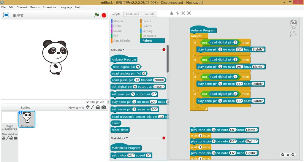

From the arduino point of view, for future reference, there are visual programming
languages, like Ardublock, mBlock, Snap4Arduino, that 6'th graders are using to
do robot work. These tools also show you the C language it generates to familiarize
you with what basic C typing looks like. There are videos that help. In fact you can
look at scratch videos as the aforementioned tools are offshoot of Scratch.
http://www.mblock.cc/
Its fun. One step at a time. You don't have to climb mount Everest these days to
learn programming, you are already doing it in your head when you use a 4 function
calculator. Buy a cheap Arduino or Cypress board. the latter more capability overall,
the former more graphical as a programming tool.
