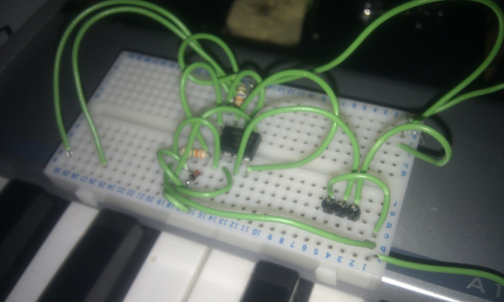

Hey everyone, i'm relatively new to electronics so please bear with me. I'm trying to make a simple 555 controller where a servo is controlled by a potentiometer linked to a 555 timer.
I've etched a PCB for all of this already and that's ready to go and the layout's fine e.t.c. but I wanted to give it a shot on a breadboard first of all to see how things go. Needless to say, things didn't go nearly as smoothly as i'd had hoped for. I amn't sure whether it's the fact that it's my first ever time using a breadboard or that my entire schematic is fundamentally flawed.
My first attempt at this yielded the following results
The minute I connect the servo to the header pins, it starts humming and begins to move extremely slowly in one direction. Sometimes it bursts for about half a second after I plug it in. Turning the pot does not change direction at all, all it seems to do is completely stop the servo from moving at all. I'm personally unsure as to whether or not it's my poor breadboard usage or my schematic that is causing the circuit to work like this.
I've attached a photo of my schematic and my breadboard with all the components connected.
Disregard the right half of that schematic, it doesn't really need any testing.
To recap, all I really want to know is whether or not my schematic is solid. My breadboard problems I can work on.

I recognize the schematic,
http://wolfstone.halloweenhost.com/Motors/svoint_RCServos.html#Driving
The link that site referred to is gone, so this is it. I suspect the design basically works but is too simple. There is a second schematic on the site that might work better.
http://forum.allaboutcircuits.com/showpost.php?p=104945&postcount=4

What brand of servo are you using? If you are taking the output header and just plugging into it, then for the vast majority of servos, you have the wrong connections. Center is + (usually red or red-orange), one side is - or ground (usually brown or black), and the other side is signal (i.e., connected to pin 3 of the 555, usually white or yellow).
A capacitor from pin 5 to ground may also help. See datasheet. Finally, I would try a larger timing capacitor and smaller resistor. Slow movements can be due to wrong repeat rate, which should be 50 Hz.

Ok first of all i'd like to thank everyone for their input. Anyway I found a datasheet for my servo and sorted out the pinouts.
There I was, thinking I had all my problems sorted out. Now I have an even bigger problem. Overnight the capacitor managed to fall out of the breadboard. I hadn't noticed that it was missing and I plugged the servo in. Instantly the servo made a very loud pop and smoke started billowing out of it. Now normally for most people that shouldn't be a major setback; just buy another servo. My problem however is that it will take 4 weeks or so for a new servo to arrive and I need this circuit done and dusted by this week.
Now I need to repair my servo, anyone know where to begin with something like this?

Well i've just had a look at the servo's amp board. It does indeed appear to be completely toast. One single capacitor blew and somehow managed to charr a fairly large section of the PCB and cracked it straight down the middle. The surround insides of the plastic casing looked as if they melted slightly as well with the heat generated.
Does anyone have any idea what may have caused all of this to happen? What was the fatal flaw? Surely a missing capacitor on the timer circuit couldn't have caused so much damage.

Could be there was a continuous DC level where there should have been a short pulse. This might be a RMS issue.
jpanhalt
Joined Jan 18, 2008
11,087
The one thing that blows a servo almost instantly is reversed polarity. That is why they (excluding a few stubborn Germans) started making the middle wire V+.

The servo that blew had the same pinout
1 - Negative
2 - Positive
3 - Signal
And I think you're right actually :(
For some unbelievably stupid reason it looks as if I have reversed the polarity of the servo. Now all I need to do is find a new servo to retest my circuit.

Ok i've done a bit of research and it looks as if the cap that blew was a polarized cap hence explaining why it blew when I reversed the polarity. I can't afford having the servo blow out on me from something as simple as reversed polarity, I need to make it secure and "idiot-proof". Knowing that, would simply putting a diode on the positive line prevent any more servo blowouts? A 1n4148 (The only diodes I have currently available? I know it will drop the voltage by about 0.6V but I can stomach a small loss in torque for reliability.
jpanhalt
Joined Jan 18, 2008
11,087
Diodes can be wired to make plugging in idiot proof, but the plugs are also polarized to make them idiot proof. Center V+ is also idiot proof. How many idiots are we trying to protect against?
Just wire center positive and forget it. Those plugs can be reversed without problems, except for not working. :D It does cause crashes, for those who don't do a pre-flight.
As for the capacitor, I suspect it was a tantalum cap. They tend go out in a spectacular fashion.

No good. I just got two servos (After four weeks, mind you :() off hobbyking. Still the exact same issue as earlier. All I get is a jump the moment I connect the battery, I can even disconnect pin 3 and the behaviour remains the same. Anyone have any ideas?
If I plug in the servo socket fully there is no movement whatsoever. If I keep a marginal connection I can get the servo to do seemingly random movement back and forth. I'm at a complete loss as to what I should do.

Is the schematic in post#1 still your current schematic, except for the pins to the servo?
If so, I will try to get it going tonight before NCIS.
John
jpanhalt
Joined Jan 18, 2008
11,087
Just noticed that the wiper on your pot is not shown connected to anything. Double check how you have it connected. The center pin should be connected to one end.
John
Edit: Seems to work OK for me. Pulse range 1.02 mS to 2.90 mS. No capacitor on pin 5 seems to be needed. The problem may be as simple as not having the pot connected correctly.
