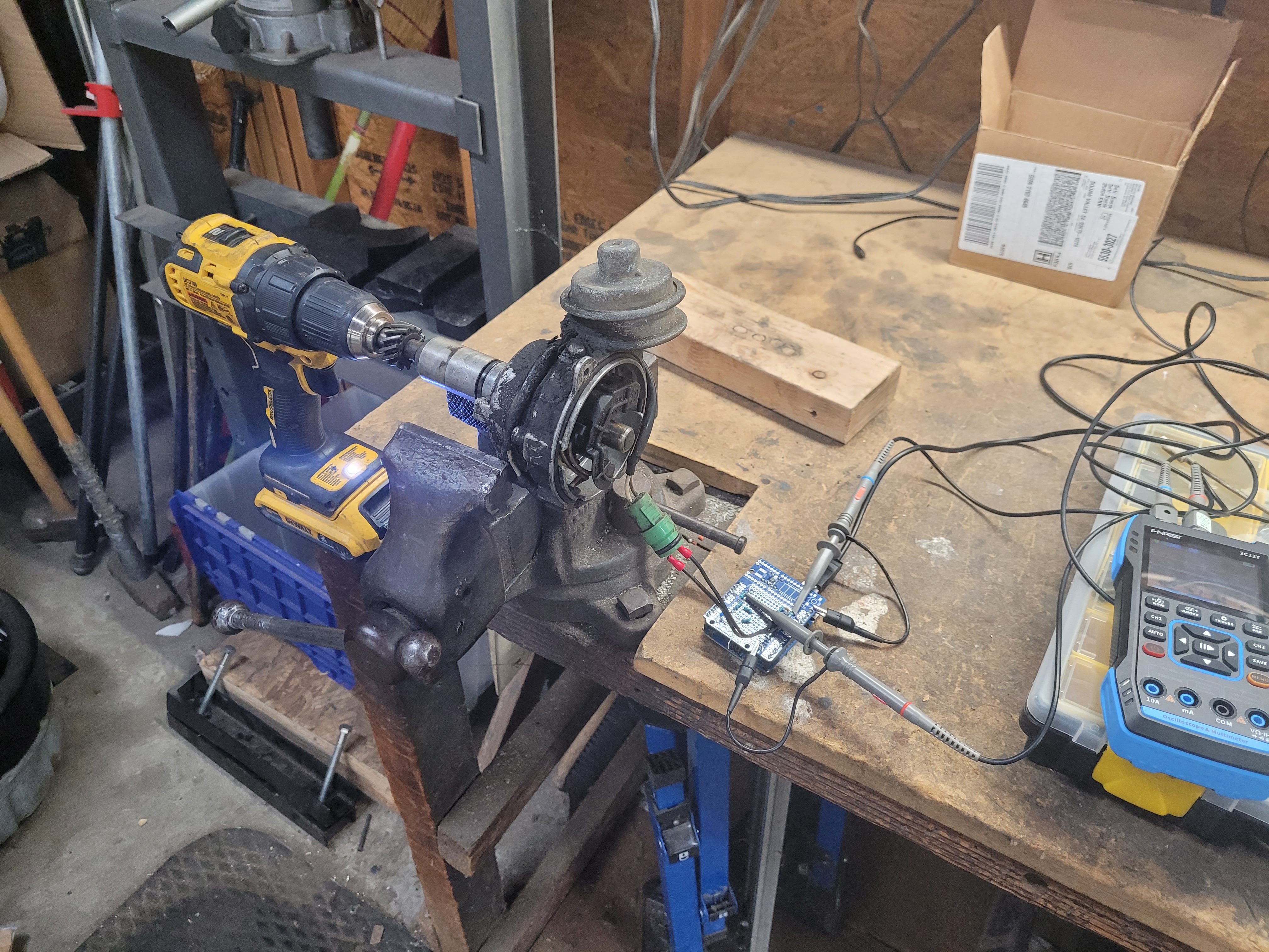

I couldn't find much information online about the Max9924 voltage comparator chip, so i built an small test board to experiment with the chip's modes of operations. For my project of making an igniter for a 22re, I need the chip to run in either a modified mode A1, or in mode B (perhaps mode C? I'll find out). These are my findings in how to make the chip behave differently.
Test Bench. Most of the tests were ran with the drill spinning 450 rpm, and all were tested on a 22r vacuum advance distributor.
This is the signal that i need to mimic.
