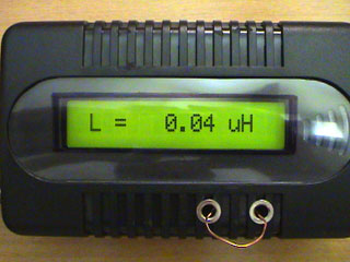

i still have problems in realizing how your circuit works • the resonant coil - if you wind it from #22 (=5·10^-3·92^((36-22-4)/39)·25.4=0.6478mm)
tight over Ø5mm you get 250nH if self interleaved over Ø3.7mm (outside diameter 5mm) you get apx. 100nH inductor -- the ®schematic does not mention the transmition frequency nor other operationals . . .
if the 100kΩ is correct then i assume the oscillator works somehow on "capacitive buffer" enabled dynamic DC - that the Spice won't even consider starting any oscillations on ?
i intentionally mounted the antenna to E through a small cap. so it would be easier to find the tune point for the circuit - as i don't yet grasp the circuit i can't tell whether it requires higher power to extend the reception distance or not
ha! , by the way - an interesting picture about Hi-Fq. wire inductance
the less the Ø (the more the AWG #) - the greater the inductance
