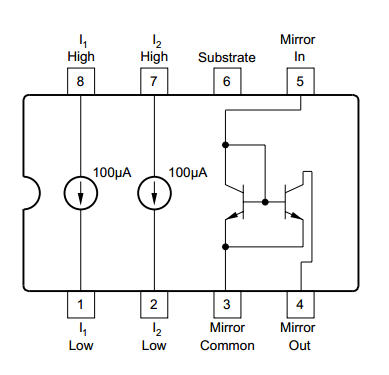

A change in the resistance in the collector T3 will result in a small change in the voltage at its base, which will lead to the same small change in the voltage at the collector T2. In T2, the Earley effect will appear, which will lead to a minuscule change in voltage already at its base, which will ultimately lead to a minuscule change in the collector current T3. So minuscule that practically the collector current T3 will not change in any way. It turns out that T3 does not get rid of the Earley effect, but only minimizes, right?

Nothing you do can get rid of it entirely. The goal is to minimize it. So the real question isn't whether the Wilson mirror improves the situation, but by how much?
As for understanding the basic mechanism by which it accomplishes this, the reason that the Early effect causes a low output impedance is because as the Vce of the transistor changes, the current changes (at a constant Vbe) right?
So if we can hold Vce constant (or nearly so), the current won't change due to the Early effect because Vce isn't changing.
So understand how the Wilson current mirror circuit makes this happen.
To check your comprehension, consider that T3, like any other transistor, is subject to the Early effect and, as the load changes, it's Vce changes considerable. Why does this not result in corresponding changes in the output current?

Below is the LTspice sim of a standard two transistor current-mirror compared to a Wilson mirror:
Note that the Wilson output mirror current (blue trace) shows only a small change in current (≈2µA) for the change in V2 voltage (purple trace) compared to the standard mirror current (red trace) of about 85µA.
Any change in Q5's current due to the voltage change is minimized by the negative feedback through Q4.

That is, in a classical optical mirror there is an emitter feedback and in an intelligent Wilson mirror there is a collector feedback?
Classical optical mirror????
In the basic current mirror, there is no feedback at all.
The reference current source (often just a resistor) establishes a current in the input transistor, which is diode-connected (which I like to think of as the "projector"). This establishes the Vbe voltage on this transistor that corresponds to that current in the transistor at that Vce. The diode connection does invoke a feedback mechanism to hold the Vbe at this value, but that isn't what we usually think of as a feedback mechanism for the overall circuit.
That Vbe is then applied to the output transistor (what I like to think of as the "image" or "reflector" transistor). IF the Vce of that transistor is the same as the projector, then it will have the same current. But as Vce changes on the image transistor, there is no mechanism to compensate and so you get an output resistance that is simply the output resistance of the image transistor as dictated by the Early voltage.
But, in a Wilson mirror, small changes in the output current feedback into the projector side of the circuit. Note that the diode-connected transistor is in the image side of the circuit instead of the projector side.
Walk through what happens if the load changes in such a way that it would try to result in more current flowing in it (i.e., if it's resistance went down).
