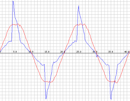

just in case anyone was wondering this is my hypothetical setup. I am going to have two 100A/1v split core transformers (burden resistor is already integrated). I have a third 30A/1V CT just in case I want to measure an individual circuit. I am going measure voltage using an ADC performing the calculations of instantaneous power on a micro controller, and send the information to my home RPI server using an esp8266. Unfortunately the esp8266 only has one ADC and it only reads up to 1.1V, so I am going to have to use another device to measure the voltage.
My thought was to simultaneously measure the voltage and amperage and calculate power by V*I. However, Yesterday as I was looking at the specs for my ADC it appears that it can only make 860 readings a second. That's surprisingly slow, especially since I was going to be measuring across 3 channels (2 current and 1 voltage). I think that comes out to only (860 hz/60 hz power/ 3 measurements) ~4 measurements per cycle, and probably will give me incorrect measurements for non-resistive loads. I think I'll just measure it with an arduino nano (I don't think I need the 16 bits of precision), which should be able to read at a 10 Khz sample rate. This should give 41 measurements per cycle, doing a little math on the arduino it will probably be more like 20 measurements a cycle if I'm measuring all three sources. I'll probably tweak the program and go back and forth between measuring the two hot lines so I can get more accurate measurements as I doubt my power demands are going to swing wildly in the 2-5 second range. I might be able to speed things up by off loading some of the calculations to my ESP8266, but I'll have to test if it would be faster to crunch some numbers on the arduino and send the results via serial, than it would be to try and transmit the raw data via the serial controller.
Is there any reason not to use an average of the instant power for my calculations, if I can have a high enough sample rate? 40-80 measurements a cycle should be enough to catch wonky behavior like this. :)
40 measurements per cycle will sample every 0.4ms.
The peaks you show in you graph have an apparent width of about 0.2ms as shown below, so 40 measurements per second may not catch that.
To catch that peak you should likely sample at about a 0.1ms period or 160 samples per cycle.
Of course that short peak does not carry a lot of energy so it's a tradeoff between sample rate and accuracy.
At a 0.4ms sample rate, the minimum voltage you would catch looks to be about 2 divisions or 14% below the peak which should not be that significant in the total power measurement.
Edit: My (admittedly rough) estimate indicates that it would cause less than 1/2% error in the total power calculation.
The data in the plot you show appears to be sampled at about 12 samples/ms or an 83μs sample period.
1ms/division
