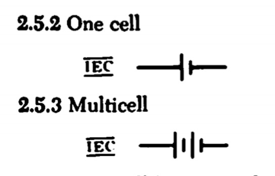

What's a battery symbol with only 2 plates?
Danko
Joined Nov 22, 2017
2,256
The two symbols in the OP are generally understood to represent two DC sources, where the one with multiple cells has a higher voltage than the one with one cell, when both appear in the same schematic.
They may indicate 1-cell vs multicell.
They dont indicate (without additional notation) precisely how many cells, or precisely what voltages.
They don't indicate technology of source, chemical or otherwise.
They don't represent signal inputs.
Symbols which are understood only by their author, are irrelevant and off topic, as the purpose of shared schematics is to communicate something understood by others.
Comprehensive description of cell/battery symbols presents in American National Standard ANSI Y32.2-1975, page 30.

Depends on the cell type, right? You could have two alkaline cells deliver only 3V while one lithium cell delivers 3.7V. :)
If the 2 symbols appear in the same schematic, without notation or comment, it would be illogical to assume their individual cells hold different voltages.

Two images drawn with LTS, what are the battery voltages.?
As I said before you cannot determine the actual voltage of a battery by the number of plates in the battery symbol.
If the battery voltage is not annotated alongside the symbol, you have no idea of the actual battery voltage.
