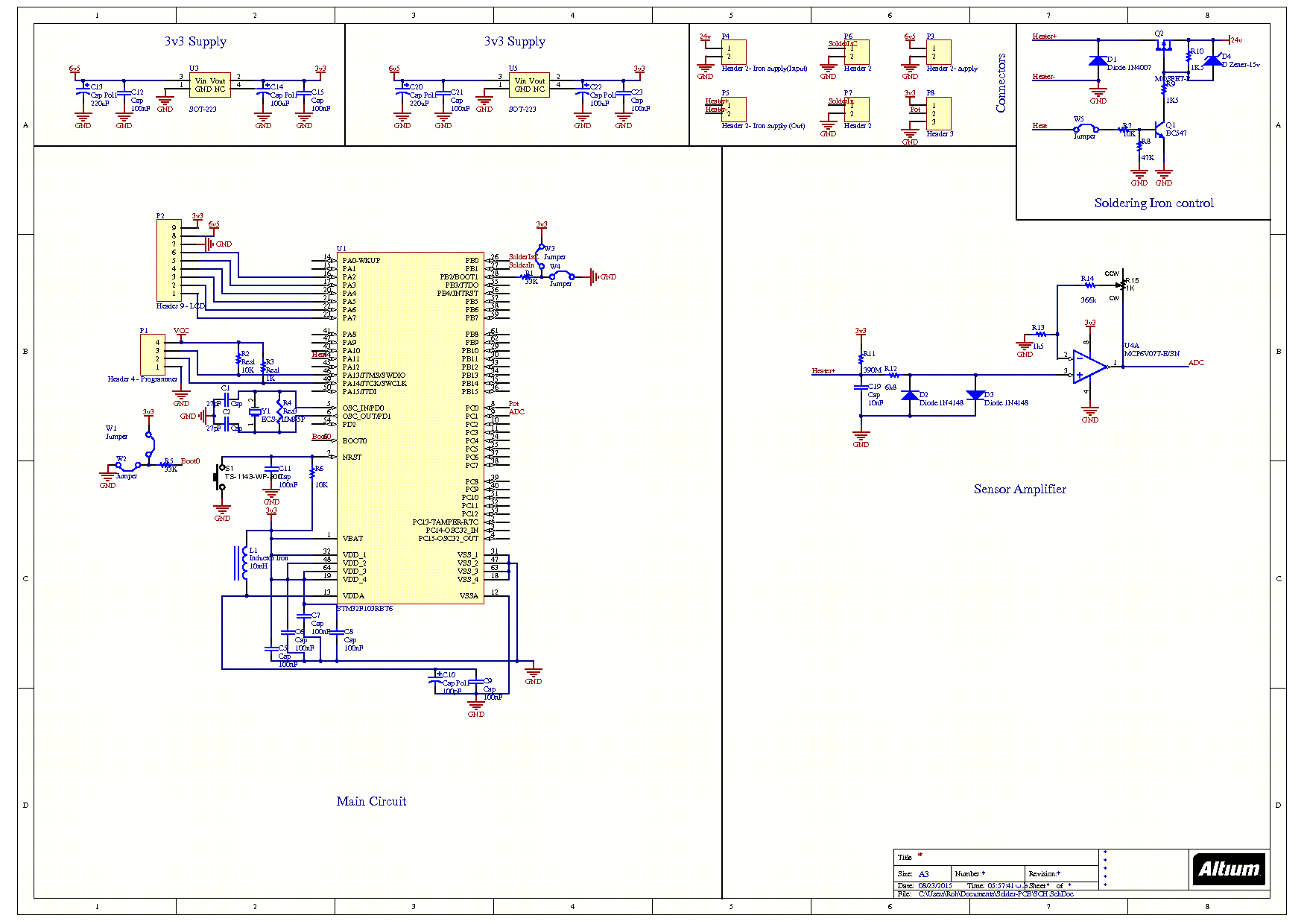

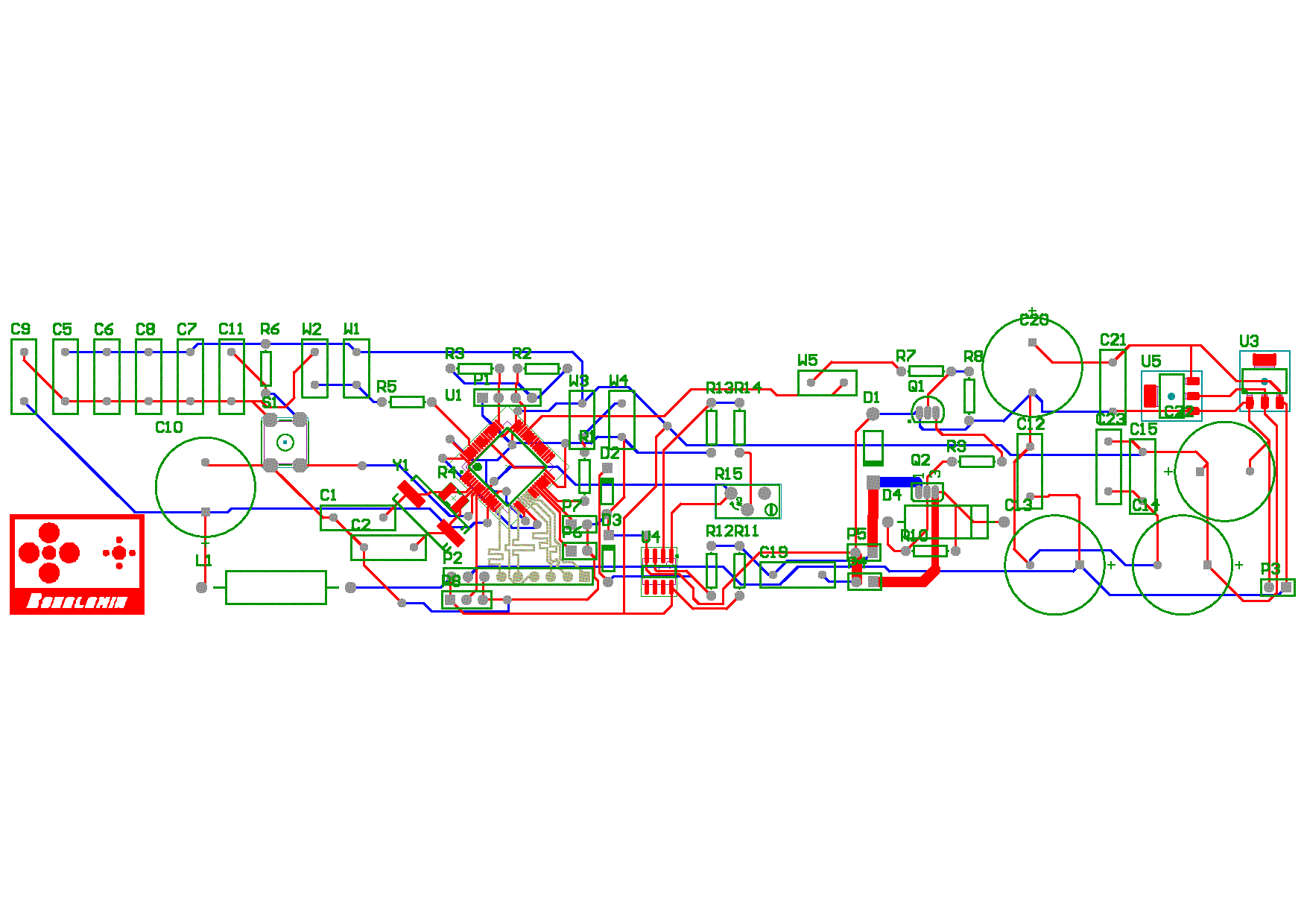

Hi
I'm working on my board and today after assembling some components on it, I ran it and unfortunately sounds like some components burnt out. it's a question to me what cause these problems. this is the schematic:
And PCB:
Also I think one problem is that I have designed two 3v3 LDO for this board to have enough current. I think that was not a good idea. Is there any other problem/mistake in your opinion?

I mean one step at a time. A complex system is very hard to diagnose, but is usually made up of smaller sub-systems. It is very much easier to, for instance, verify that each IC has power to it as expected. Yes? Then start checking the input and output pins of the IC. Sometimes you need to separate the sub-systems completely in order to verify they are working. I think I saw at least one transistor as a switch in your schematic. You can probe to see if that transistor is functioning as you need it to.
JohnInTX
Joined Jun 26, 2012
4,787
You don't say what the PN is but your two 3V3 regulators are not pinned like the SOT-223/DPAK stuff I am familiar with. The tab is usually GND. You show GND as where I would expect the input. Miswiring the regulators would account for what you are seeing.
Also not sure about paralleling them.
What is the PN of your regulators? Are they like any of these?

I assume you didn't connect the lcd directly on the board connector ie. 1-1, 2-2 etc?
Did you try powering the board without the lcd connected?
Are both of the 3.3V regulator outputs connected directly together?
Did you run any design rule checking on the pcb layout?
Yes, I didn't.
Yes. the last time.
Yes, but I think I should to use two diode. because of this:
http://electronics.stackexchange.co...-together-to-produce-higher-amperage-possible
Also the last time I removed one of the LDOs from the board(+ it's capacitors).
No, How can I it in the Altium?
